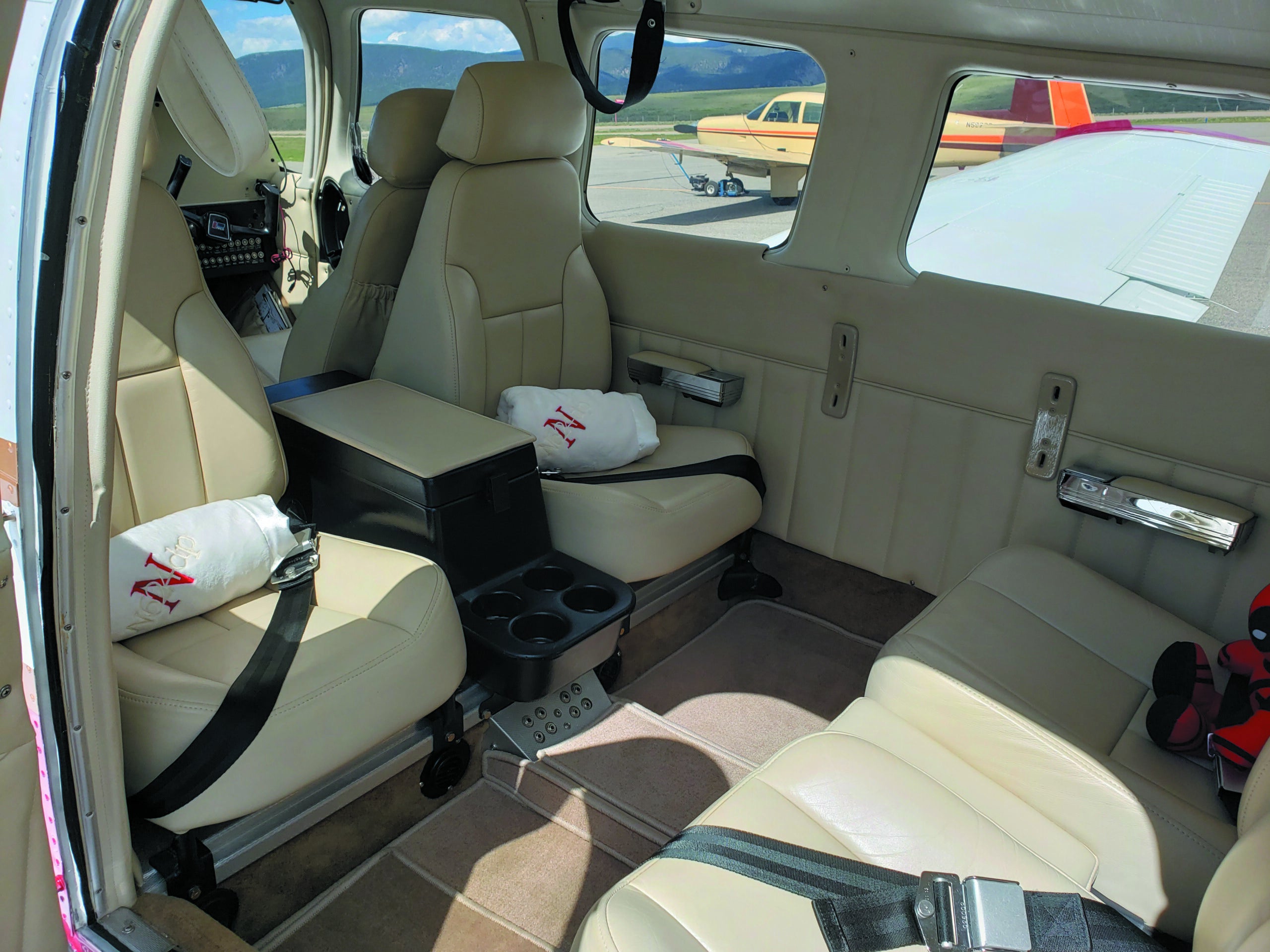

Engines, exhaust systems, propellers, cabin vents and aging door and window seals are just a handful of sources that can make the typical aircraft cabin a miserable place to spend hours on end. It’s also a path to irreversible hearing damage. How do you know if your cabin is too noisy? Fly in a comparably designed newer one, or one with cabin upgrades like that Piper Saratoga cabin in the image to the left.
