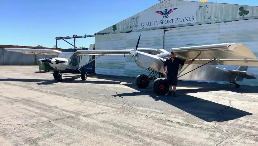

This personalized “Sky Jeep” was modified by Ivan Gromala, the owner and manager of Quality Sport Planes, Zenith’s West Coast representatives.
  • Ivan Gromala of Quality Sport Planes (QSP) successfully converted a standard Zenith STOL CH 701, originally designed with a nosewheel, into a custom taildragger.
  • The conversion, driven by customer interest and the need for increased prop clearance in backcountry flying, took approximately 250 hours and leveraged Gromala's technical background and external advice.
  • The resulting taildragger exhibits significantly improved short take-off performance, getting airborne in just 50 feet, which Ivan describes as a "whole different animal" compared to the original.
  • Zenith Aircraft is currently evaluating Gromala's design with the intention of developing and offering a commercial conversion kit, responding to high demand from other builders.

Ivan was inspired to do the conversion because numerous QSP customers showed interest. His shop is located in beautiful Cloverdale, California. Wine country. He noted there are some really nice spots to fly in and out of, where you might want more prop clearance. His airplane has a 75 inch three-blade WhirlWind propeller, Rotax 912 ULS with an Edge Performance fuel injection kit and Beringer wheels and brakes with 29 inch Alaskan Bushwheel tires on it.
As for the gear and shocks? Tony of Shock Monster created those. Ivan modified everything for the airframe to fit the gear and tailwheel, which took a lot of trial and error. His tool, die and machinist background proved valuable as he worked to get it structurally sound. He’s still working with the gear to get it more aligned by changing angles, camber, tire pressure and pressure for the shocks.
Ivan didn’t build his CH 701 himself. He purchased it from a customer and flew it as a trike for over a year. The tailwheel conversion project took roughly 250 hours total, accumulated over the course of a year. “Would’ve been a lot less now knowing what I know,” he laughed.
He did most of the work himself and received a lot of valuable information and advice from his “old timer” friend, Eric, who’s been a tailwheel pilot the entire time he’s been flying. “If I don’t know something, I’m gonna ask people who’ve done it and who have gone through building different airplanes throughout their lives,” Ivan said. “You know, that knowledge you can’t get from a book.”
When asked if he ran into any major obstacles, Ivan said everything was really doable; he just lacked time. He’s a general engineering contractor who runs an excavation company during the week and QSP during his free time and on the weekends. QSP offers builder assistance, so Ivan’s very busy overseeing that.
Ivan finished the gear conversion project roughly five months ago and went right into tailwheel training, earning his endorsement shortly thereafter. I asked how his airplane compares to the tricycle gear version of it and he said, “It’s a whole different animal.”
“I can’t tell you differences because I haven’t flown other tailwheels,” Ivan said. “But it pops off the ground in 50 feet.”
