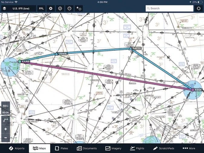

I’m based in Wichita, Kan. I occasionally fly to Springfield, Mo. A direct route, which clearance delivery always seems willing to approve, takes me through the Eureka MOA. Of course, IFR operations are prohibited in an active MOA. The MOA is not commonly expected to be hot, which is how I brief and file, but my experience is that somehow it is almost always hot once I get in the air. (Something about me being airborne seems to attract high-performance jets.)
This means I’m usually re-routed or simply vectored around, sometimes abruptly from a point inside the MOA when the Air National Guard decides it’s time to start mixing it up. I’d much rather file and be cleared for a route around the MOA. I use UBWIK GATTY Direct, so I have less chance of having to update my routing and my flight plan en route. That route is depicted on the en route chart shown below in blue, with the direct route in magenta.
KAAO_KSGF_Foreflight_ScreenShot
That may seem like it’s way out of my way, but in the Bonanza I fly it usually adds only four minutes to the time en route. And, once past the corner of the MOA on the leg to GATTY I can ask for—and usually get—direct to destination. It’s easier and quicker to pick an existing waypoint on a GPS flight plan and “go direct” when I ask for it, than it is to find an unfamiliar waypoint and insert it into an existing flight plan when it’s convenient for the controller.
