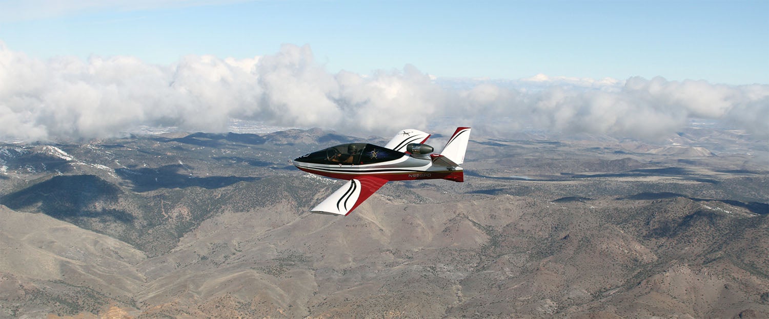

Flying your brand-new jet (that you built yourself) in the mountains—it doesn’t get much better than this!

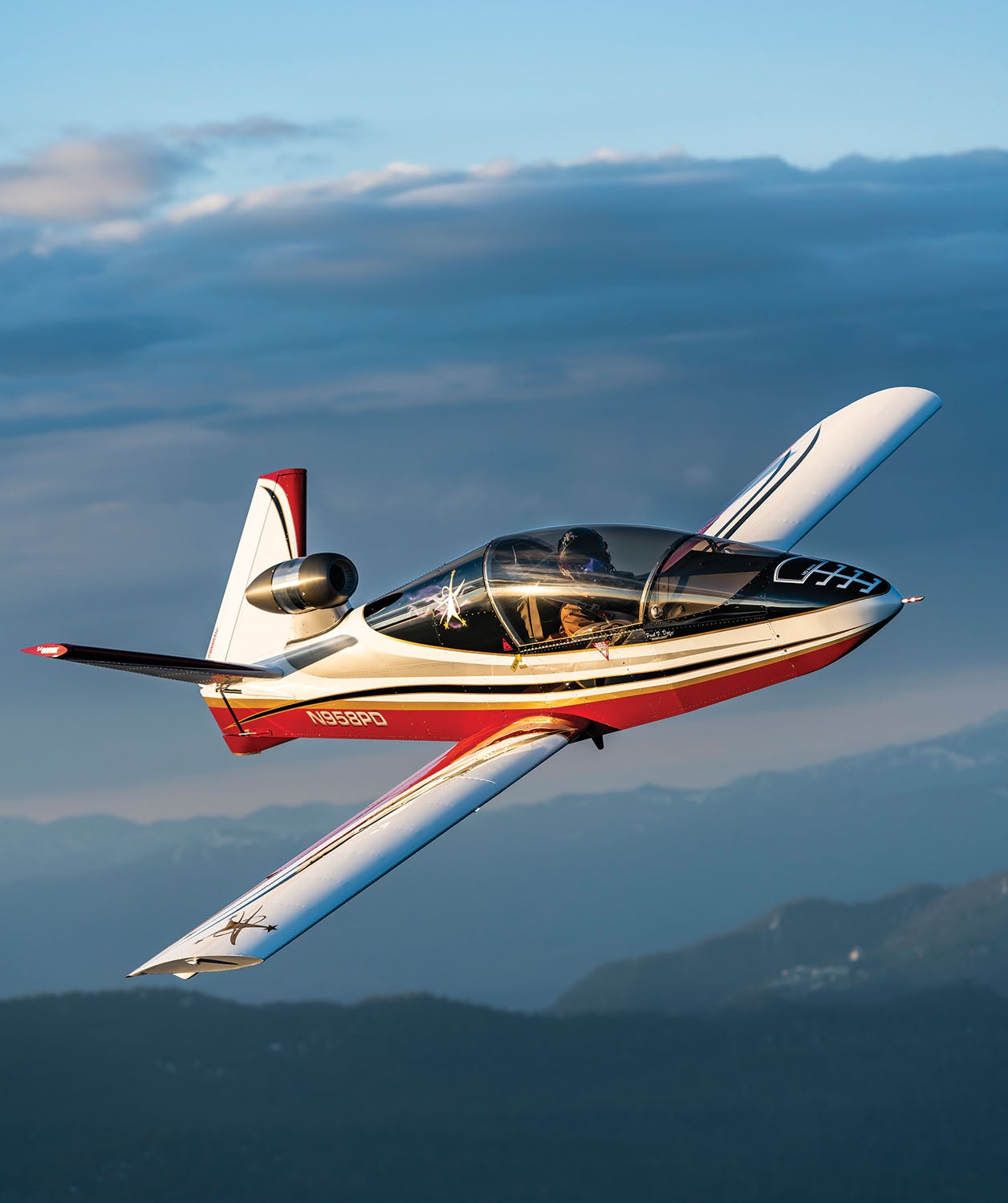

Sunrise over Lake Tahoe means beautiful lighting and smooth air for tucking in tight on the camera ship.

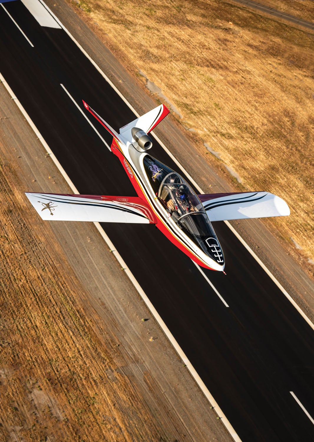

A parting break—and a view of John Stahr’s artistic ability you just can’t get with the airplane on the ground.
