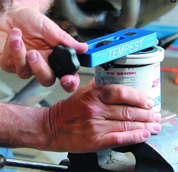

You can mount the Tempest tool or place the filter itself in a vise. Mounting the filter makes a bit less of a mess. Install the tool and begin cutting the can (as shown in the picture), increasing the tension on the cutter via the black knob as you go.

The Tempest AA470 depends on the tool holding the center of the filter in place while you rotate the canister along the cutting wheel. But here’s the cool part: The AA470 has a removable pin that allows for both the 48110- and 48108-style filters—leave the pin for the -108, remove it for the -110. Other tools may use a sleeve that fits over a smaller pin that itself goes inside the male, but that also requires moving the cutting head by way of a bolt-on spacer. That’s all fine if you only cut one kind of filter, but the Tempest is the hot ticket if you have to manage both.

Removing the black pin determines which of the two primary filters the AA470 works with.
Quite well, thanks for asking. The long sides of the AA470 are straight and parallel, as well as plenty thick, so securing the tool in a good-sized vise is easy. But I actually prefer to secure the filter in the vise and use the tool freehand to remove the filter base. After all, there’s going to be some residual oil in the filter, so you might as well let it stay in the housing as long as you can. Either way, the Tempest tool works well, with a sharp cutting wheel (replacements are about $10), a large knob for setting cutting effort and enough overall length to provide good leverage.
