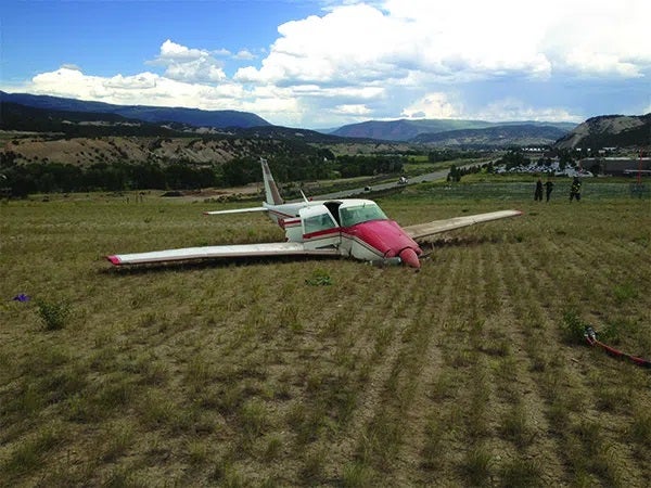

This Piper PA-24-260 Comanche 260 came to grief outside Eagle, Colo; on June 28, 2013, after its engine quit due to fuel starvation. Both pilots aboard suffered serious injuries. Examination revealed the fuel selector was positioned to the left tank, which contained two gallons. The right tank contained 9.5 gallons of fuel. Worn and corroded fuel senders contributed to the pilots' improper fuel management, according to the NTSB. Image: NTSB
