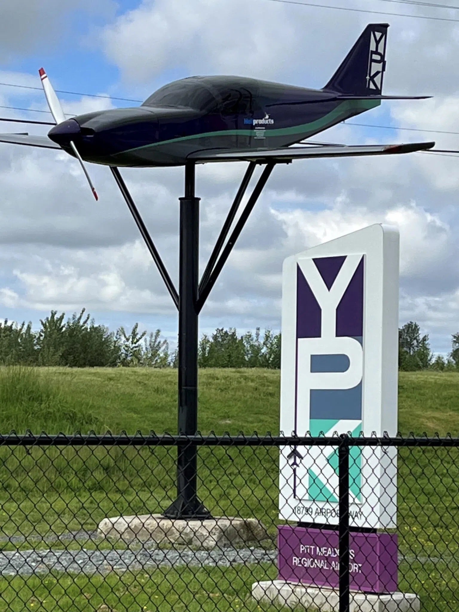

This image appeared in my inbox and I wondered how I might feel driving past it. This is a Glasair II FT that was recently mounted to serve as a “gate guardian” at Pitt Meadows (YPK) in British Columbia, Canada. I imagine I’d be ecstatic to stumble upon it. These little composite planes make my heart happy. I’d love to be welcomed by something I’ve dubbed friendly and familiar. To many, this airplane means nothing. But for a lot of us it’s symbolic. We see the smooth cowl out of the corner of our eye and a wave of pride and familiarly washes over us.

“I discovered the aircraft in literally dozens of pieces and in a complete state of non-completion,” Chris said. “I bought the aircraft, bits and pieces and related hardware from the family and trucked it to Pitt Meadows.”
The wing was already assembled, minus the flaps and ailerons. Clarence didn’t have the required inspections done in the proper sequence (Per the MD-RA program in Canada) so the wing was condemned and the airplane became a sitting duck, so to speak. Chris used auto-grade epoxy resin to assemble the aircraft, as it would never fly. He used fiberglass to seal the wing root and join the elevator to the horizontal stabilizer. He also sealed the flaps and ailerons to the wing to prevent birds, bees and the like from nesting in it. The main gear, brakes, nose gear and rudder pedals have all been removed.
Once assembled, it was time to paint. Chris received help from Jason Caffrey of Heli Products, a helicopter company at YPK, who has access to a downdraft paint booth. The airport chose and paid for the paint scheme. The prop and spinner were donated by one of Chris’ clients, Tim Eggleston, which they prepped and painted accordingly. Chris used a planetary gear from a helicopter to get the propeller to spin freely. He also used solar lights to make the nav lights glow in the dark. The project took about two and a half years to complete.
Glasair welding
Local welder, Calin, completing the bracing.
At last, it was time to mount their masterpiece. Airport manager, Guy Miller, hired an engineer to design the support structure. The triangular bracing system is that of the engineering effort and Chris feels it does its job without taking too much attention away from the display. Time was spent installing steel plates and solid pick-up points in the wings and the fuselage. Chris and his crew used a cement block from an old gas station as the supporting ballast. Stephen Van Dolder, a member of Operations of YPK, planted the block and neighboring flag poles. Before they knew it the airplane was sitting on the 14-foot-tall display pole for all to see.
“The one time it did fly was on the end of a crane for an hour or so,” Chris laughed.
YPK gate guardian
YPK’s new gate guardian taking flight.
The airport plans to install a garden at the base of the Glasair. There’s a popular walking trail near the airport, from which people can marvel at YPK’s new gate guardian. To most, it’s just another airplane. But those of us who know and love it will smile a little brighter. Although this Glasair will never fly, Chris still managed to bring it to life.
