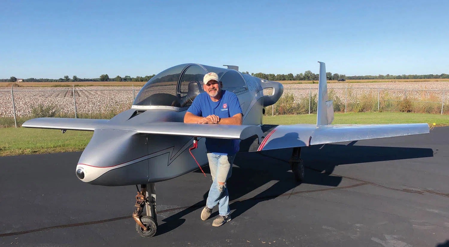

Ryszard Zadow with the VariViggen.

The Rutan Aircraft Flying Experience, a nonprofit organization based in Covington, Tennessee, is dedicated to preserving, flying and training pilots in Burt Rutan’s canard designs. Ryszard Zadow, the founder and prime mover behind RAFE, had a dream—he wanted to acquire a flying example of each Burt Rutan homebuilt design and fly them at places like the Experimental Aircraft Association’s annual AirVenture airshow.
