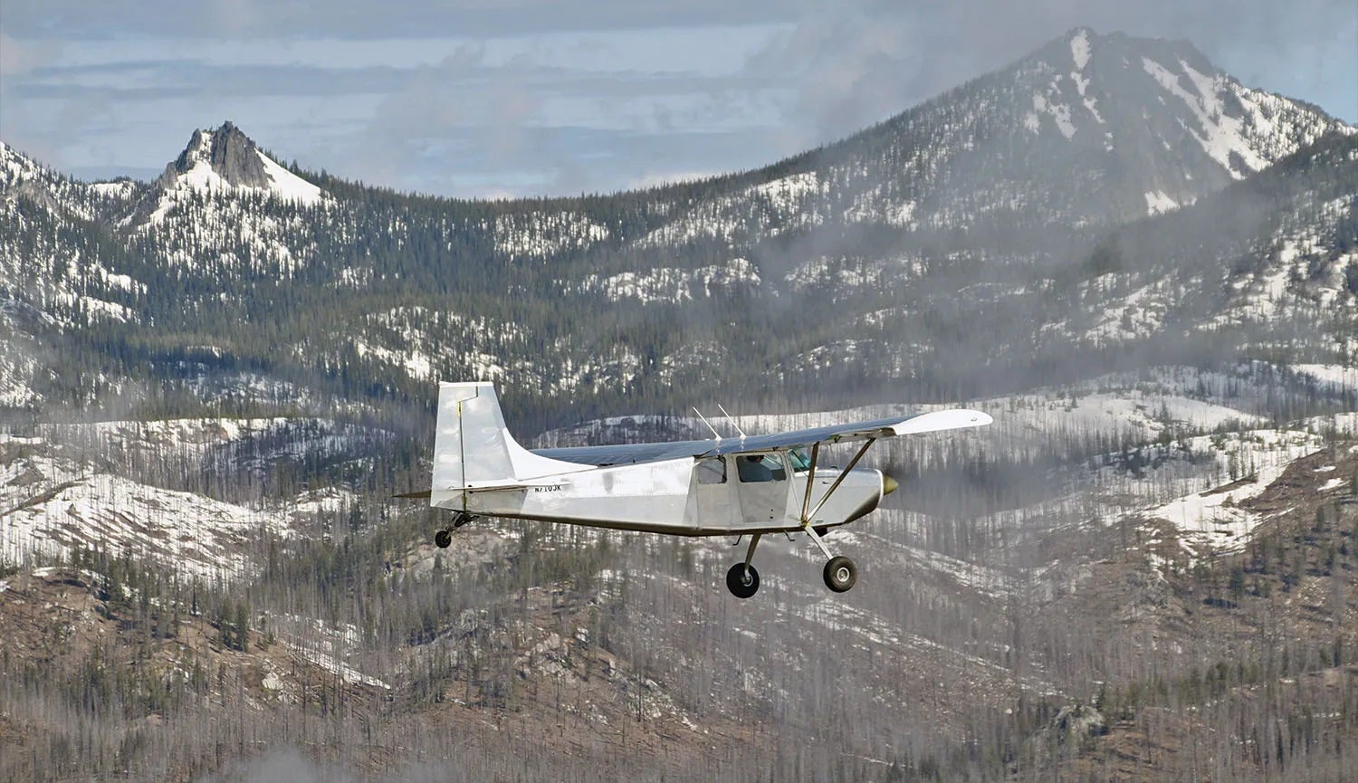

And then there is our Dream Tundra—the genesis for this article. Developed in the early 2000s in Canada, our example was the first to be purchased as part of the factory-assist program and was probably in the first five serial numbered kits to be delivered. And with that introduction, our story begins.

The Dream Tundra is a four-place, all-metal high-wing utility plane designed and marketed for backcountry pilots. The prototype was built as a floatplane, with the taildragger main gear implemented on later aircraft. Dream was based in Canada, with the principals, including the designers, drawing on the desire for a plane that could carry reasonably large loads in and out of rough locations reachable by water or backcountry strips. Aiming at the Cessna 170/180 crowd, the airplane received positive reviews in various publications, including KITPLANES® (in the March 2004 issue). Indeed, it flew well and performed as promised when it came to range and carrying capability.
