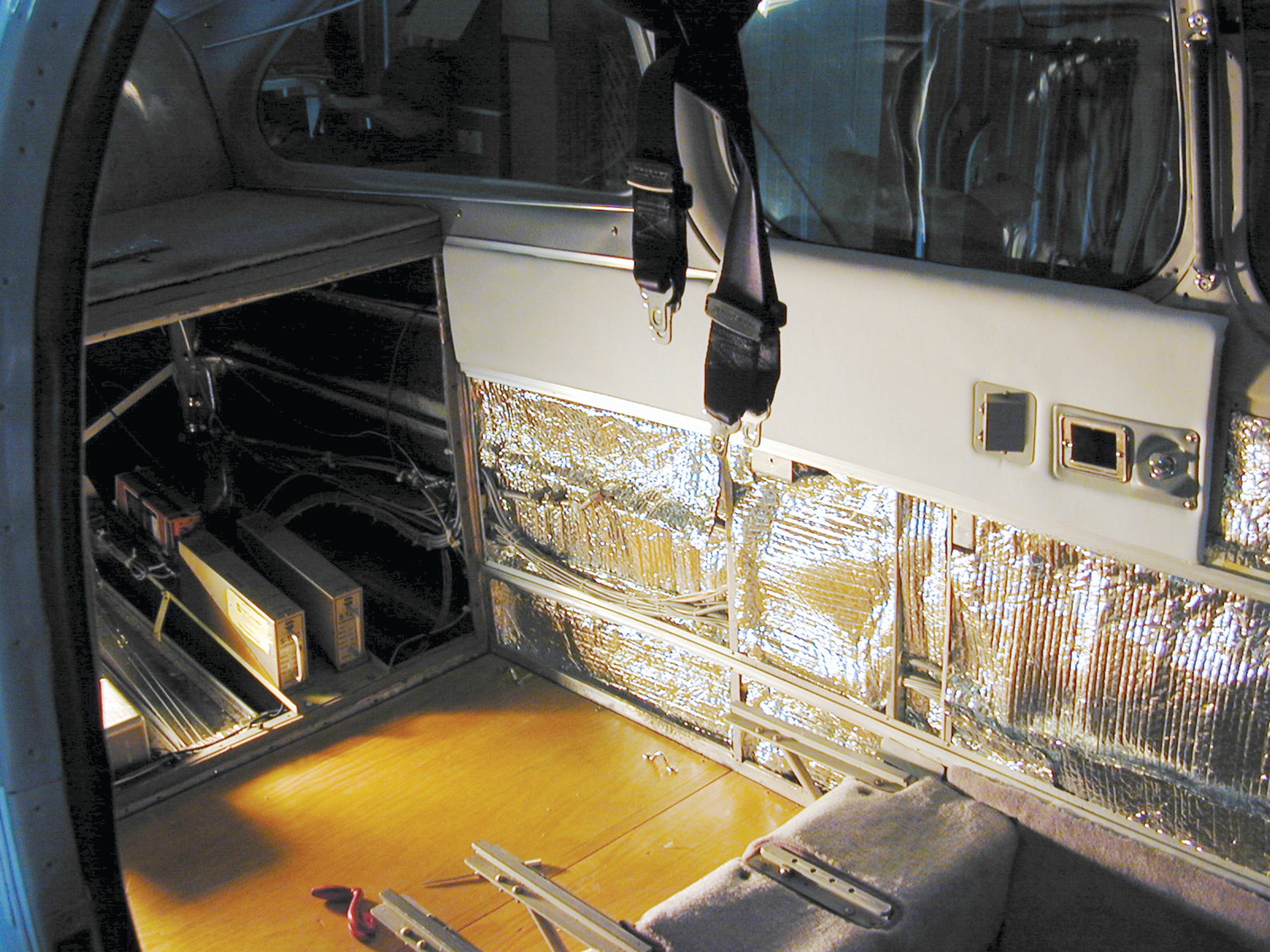

2. Interior
Appendix A specifically mentions the “decorative coating of…cabin, or cockpit interior when removal or disassembly of any primary structure or operating system is not required.” The same basic language applies to “upholstery and decorative furnishings of the cabin, cockpit, or balloon basket interior.” That’s a permission slip that can save you thousands of dollars in labor.
Depending on the aircraft, upholstered overhead and side panels are relatively easy to remove and refinish, and don’t involve any primary structures. The project can be as simple as repainting worn plastic bits or as involved as ripping out everything including the insulation under the floorboards for new. Yes, you also legally can replace your airplane’s soiled carpet.
But this can be a big task, and not all of us have the skills to make the end result look as professional as we may want. The good news is you can remove the interior panels and reinstall them after someone else does the detail work. A good time to tackle such a project is when the aircraft is opened up for its annual inspection, since much of a typical aircraft’s interior needs to come out anyway.
Removing an aircraft’s interior also affords us a good, close look at what’s in the sidewalls and under the floorboards. You can use the opportunity to check the overall condition of any wiring, pitot-static plumbing or other systems. Removing interior panels may expose the primary flight control cables. The only thing you can/should do is examine them for corrosion and wear, and carefully—generally, you want to keep lubricants and chemicals away from the cables themselves—lubricate their pulleys.
