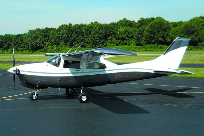

Cessna 210 Centurion. Photo credit: Aviation Consumer

Having owned a 1978 T210 for over 20 years, I found the article accurate but missing one important point: CO in the cabin is a common problem. The aircraft operates with the cabin at negative pressure, and the exhaust is pulled inside the airframe under the cabin floor. The inspection plates in the floor of the cabin must be sealed with duct tape. The standard exhaust heater is prone to leaks, with spiral fins welded to the inner tube. 50 hr. inspections required. Replaced by the Knisley exhaust with headless screws welded to the inner tube instead of the spiral fins, inspection goes to 100 hr. A CO detector is a must.
A fuel efficient (14.5 gal./hr. at cruse, LOP), load carrying and tough airplane with still the best efficiency in its class.

A strut-braced (1964?) C210 was the first airplane I ever “flew,” aged around 4 and sitting on a booster seat so I could see over the nose and see where I was steering. Handling gear and flaps on command prepared me for later life as a copilot. I remember an argument between my father and the co-owner over whether the nose gear retracted forward or aft being settled by cracking the gear doors open with the emergency handpump. After many memorable family holiday and dad and son weekend that plane was sold because the co-owner upgraded to a 310. The need to haul a family of five remained and was taken over by a club owned 1980 T210N which is connected to various trips during my teenage years. It even had radar! Having to use a C150 to get my own PPL sure felt like a step down after all that Centurion time. Having earned my license and some hours I was allowed to fly another T210, this one with Stormscope. When hired by an airline to fly a DeHavilland Dash 7 there was no big difference in speed or handling to cope with. My last C210 flight was in 1995 but I shall always keep a fond memory of that versatile plane.
