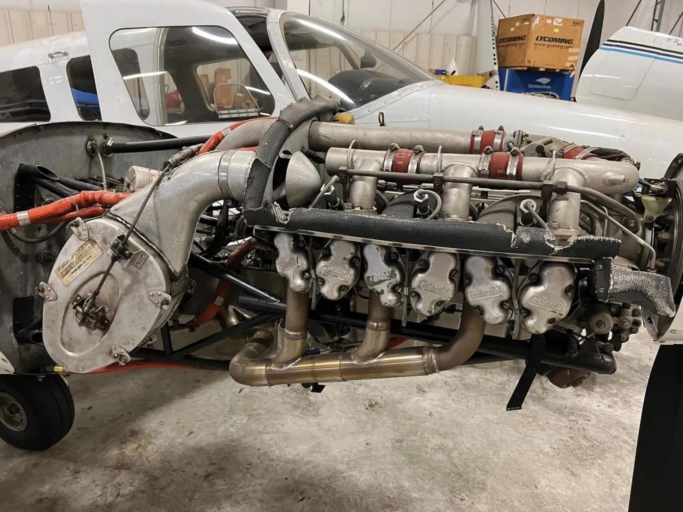

That’s one of two turbocharged Continental engines on a Piper Seneca II. With the right operating techniques, a good engine monitor and focused inspections, the turbos can last to engine TBO and beyond.
