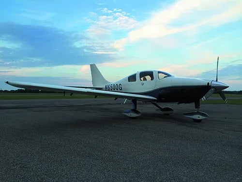

Modern and well-cared-for composite aircraft like the 2004 Columbia in the main image are worth considering, but only after a focused inspection.
