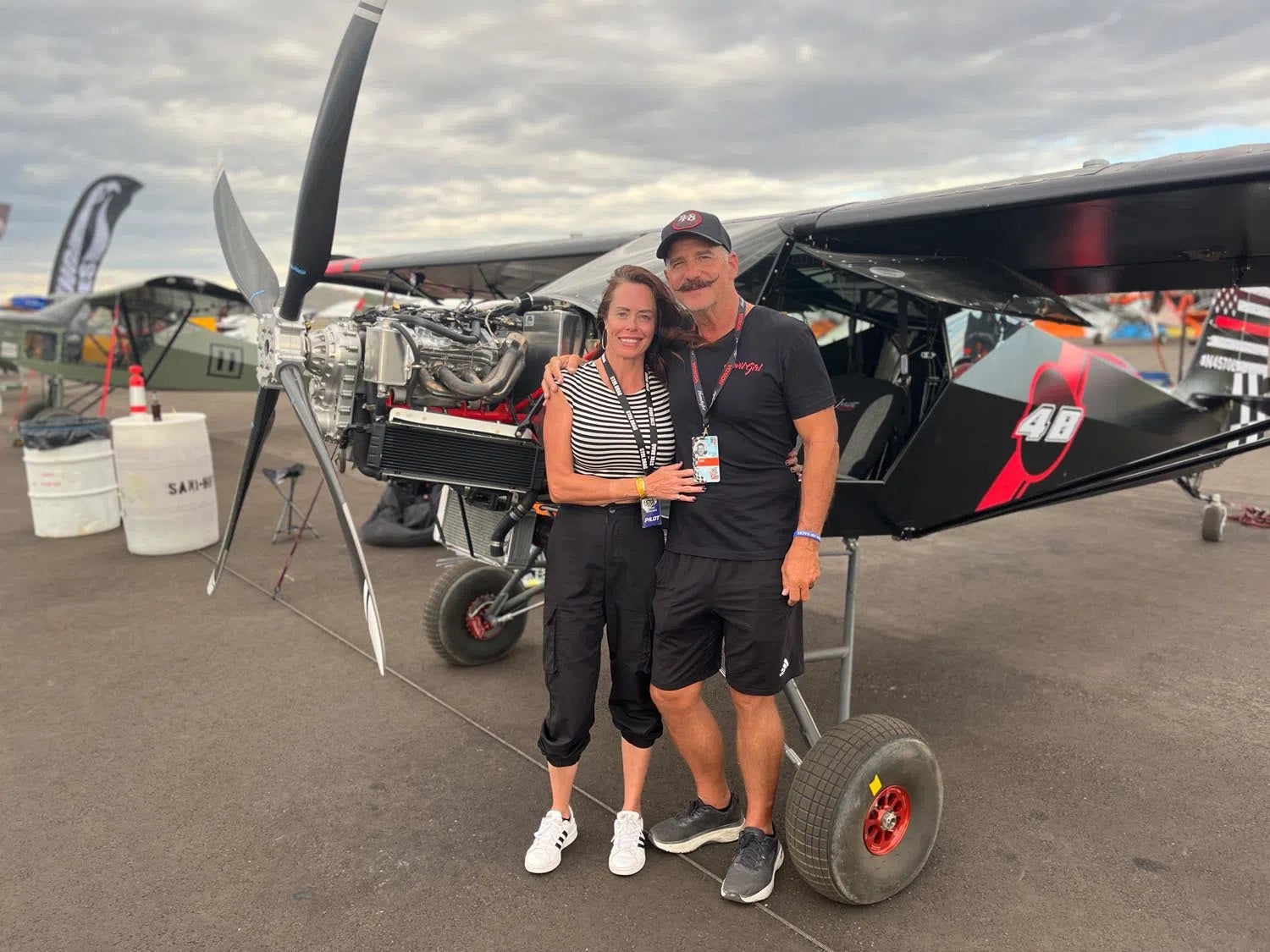

Devil Girl namesake Sherri Sanches and pilot/builder Eddie Sanches.

Eddie Sanches herds an American Airlines 777 around for a living, but on the weekends he enjoys the rough and tumble world of STOL drag racing. Three years ago he purchased and raced a Just Aircraft Highlander with a Rotax 914 engine, which he later upgraded to an EP 912, putting out 155 hp. At ArkanSTOL 2022 (what a great name for a STOL event) Eddie ran into seasoned STOL racer Kevin Hoopes, who was working on a one-off Highlander XL designed with modifications to make it a top tier competitor. Sadly (or not so sadly in Eddie’s perspective) Kevin then became a partner and designer at Badlands Aircraft to work on their new Vaquero model. Kevin had to devote his time, attention and loyalty to the new brand, so he and Eddie struck a deal where they would both finish the new Highlander and Eddie would walk away with the keys at the end of the process. Eddie and Kevin finished STOL Race 48 only a month before Reno.
Skytrax gear box and 4 blade NP prop.
What resulted was the creation of a next level Highlander with an incredible new powerplant and stunning build quality. The engine on this creature comes from the world of Yamaha snowmobiles (“snow machines” if you are from Alaska). Officially the engine is designated the Sidewinder 998T, and yes, the T stands for turbo. This little 3 cylinder engine currently puts out about 250-260 horsepower, but Eddie is expecting tweaks to bump up that number to over 300 hp. The engine spins at 8200 rpm static and 9300 in anger. All that torque is converted to thrust with a Skytrax fully reared gear box built by Teal Jenkins and a four blade NR prop.
