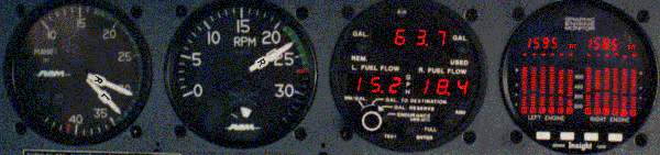

Take a close look at the photograph below. This is a the panel of a Cessna 414 inflight. Both engines are equipped with turboGAMIjectorsand both are operating at the same cruise power. EGTs and TITs are approximately the samefor both engines, are is engine RPM. Yet the left engine is consuming 3.2 GPH less fuelthan the right engine. At the same time, the left engine has CHTs that are between 25F and50F lower than the right engine.
QUESTION: What the heck’s going on here?
Cessna 414 panel
ANSWER: The right engine of this airplane has been leaned to 50F rich-of-peak,while the left engine has been leaned to 50F lean-of-peak. Since leaning from 50FROPto 50FLOP results in approximately a 10% loss of engine horsepower, the left enginepower was restored by increasing the manifold pressure by about 3 inches.
Most of the pilots and so-called “engine experts” I’ve talked to look at thisphoto with disbelief because they expect that the engine that is leaned more aggressivelyshould run hotter. But they’re dead wrong! It turns out that at any particular powersetting, maximum CHT occurs at around 35F ROP, and than either enrichening orleaning from that point causes CHTs to go down! This is precisely what engine theorypredicts, and precisely what the mixture-vs-temperature graph in the TCM engine operatingmanual shows.
How the widespread misconception arose that “leaner is hotter” is beyond me.The fact is 50F ROP (where most people operate) is very close to the maximum CHT point.Leaning further to peak EGT actually causes CHTs to come down a little, andcontinuing to lean to 50F LOP makes them come down sharply. The instrument readings in thephoto above clearly demonstrate this to be true.
You could achieve the same kind of CHT reduction by operating ROP, but todo so you’d have to run so rich (around 200F ROP) that your fuel flows would go to themoon and your engine would become quickly contaminated from unburned combustion byproductsresulting from the excess fuel.
