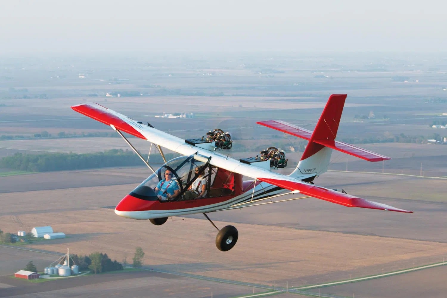

Airplanes are designed for particular missions. Some are simple ultralights designed to lift you off the ground for a few minutes in the golden hour of evening light. Some are fast performance cruisers intended to whisk you and your baggage across the country in short periods of time. Others are designed to ring out your vestibular system with high-rate aerobatics—or to plunk you down on a short rough strip beside a secluded lake in the mountains. Trying to use a point-designed aircraft for a purpose other than what it was intended for often leaves one unsatisfied. No matter what the purpose of the airplane though, it is important to remember that someone took the time to design and build an aircraft for the niche in which it lives. And some of those niches are fascinating to explore—and to experience.
The AirCam is one such airplane, something that clearly was designed for a particular purpose—for a specific mission—and one that throws some conventions to the wind in order to accomplish it. I have heard it described as a pterodactyl merged with a canoe. It’s an ungainly description that some might think insulting, but is actually descriptive of an airplane with a singularly interesting mission. The AirCam was, in fact, designed to be used as a photographic platform in remote terrain—Africa to be exact. And its design has proved to be spectacularly successful as a low-and-slow, wide-open photographic machine with plenty of performance, rugged construction and excellent redundancy to keep you from becoming a pedestrian hundreds of miles from civilization.
The longish nose sits high above the ground, giving the impression of an airplane that is larger than it really is. In reality, the AirCam is not much larger than a Cub.
KITPLANES has reviewed the AirCam before (“AirCam Adventure,” April 2009) with glowing endorsements for both its mission capability and its sheer fun flying experience. But that was years ago, before my tenure with the magazine. Despite my good intentions and desire to fly as many different aircraft as possible, it was only recently that I finally found the time to get together with designer Phil Lockwood at his Sebring, Florida, base where the AirCam kits are produced, to sample this delightful aircraft and report on just how enjoyable the “AirCam Experience” can be.

The airplane was designed to be easily broken down for transport over rough terrain. The wings are easily removed, with the center section remaining attached to the fuselage. Pictures on the AirCam website of the original Congo expedition show the fuselage being towed on narrow logging roads through the jungle, while the wings are being carried by two people. Since the empty weight of the entire aircraft is around 1100 pounds, breaking it down into smaller sections makes it transportable by simple methods in places where high-tech transport isn’t available.
Of course, the real magic of the AirCam for a photographer is the view, and this was what made the design with the long skinny nose so desirable in the first place. Lockwood has kept this feature, even while adding a third seat (which sort of takes up the space that was used for baggage in the two-seat version), and even that third seat has a pretty good view.

As I mentioned earlier, I tend to think of the AirCam as a very large airplane. Possibly this is because on floats or wheels, it stands tall. Possibly it is because of the fuselage length (a tandem-tandem that will hold three people or two with a lot of baggage). And possibly because it’s a twin, and twins are supposed to be large.
But the truth is, this airplane has the wingspan of a Cub—not an airplane that we associate with the word “large”—and it has a maximum gross weight of 1900 pounds. With an empty weight of 1100 pounds, that leaves 800 pounds for fuel, people and gear—not bad for a twin-engine “Cub.”
It is actually quite normal in size and fits nicely in an average hangar space. The baggage area/third seat is plenty large for anything (or anyone) you want to put back there.
At any rate, once we opened the hangar door and I really walked around the machine, I realized that it really is right-sized—not excessively large, but tall enough to walk around comfortably. The fuselage does give you that “canoe” feeling because it is narrow, and you are sort of sitting on top of an aluminum canoe. But that fuselage is what makes this such a fun and wide-open airplane to fly. With the wing mounted well aft (or the nose a long way forward—take your pick), the visibility is simply astounding. From the front seat, it is hard to even see the wingtips, and the low fuselage sides don’t get in the way when you look almost straight down. This is indeed a great seat in which to put a photographer.
