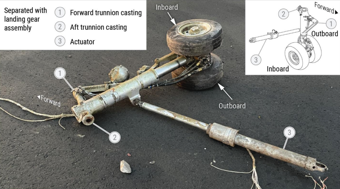

The action stems from the NTSB’s ongoing investigation into a Feb. 10 runway excursion in Scottsdale, Arizona, involving a Learjet 35A that veered off the runway and struck a parked Gulfstream G200. The Learjet’s captain was killed, and three others were seriously injured. Investigators found that the left main landing gear separated from the wing structure after an incorrectly installed retaining bolt failed to engage the trunnion pin.
The misassembly, the NTSB said, cannot be readily detected during routine maintenance or preflight checks. The agency’s report noted similar cases in 1995, 2001, and 2008, in which Learjet main gear detached after improper installation.
