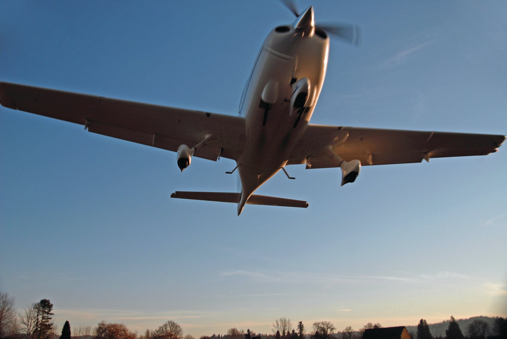

Aircraft Profile: Cirrus Design SR22
OEM Engine: Continental IO-550-N
Empty Weight: 2250 lbs.
Maximum Gross Takeoff Weight: 3400 lbs.
Typical Cruise Speed: 170 KTAS
Standard Fuel Capacity: 81 gallons
Service Ceiling: 17,500 feet
Range: 1049 NM
VS0: 59 KIAS
