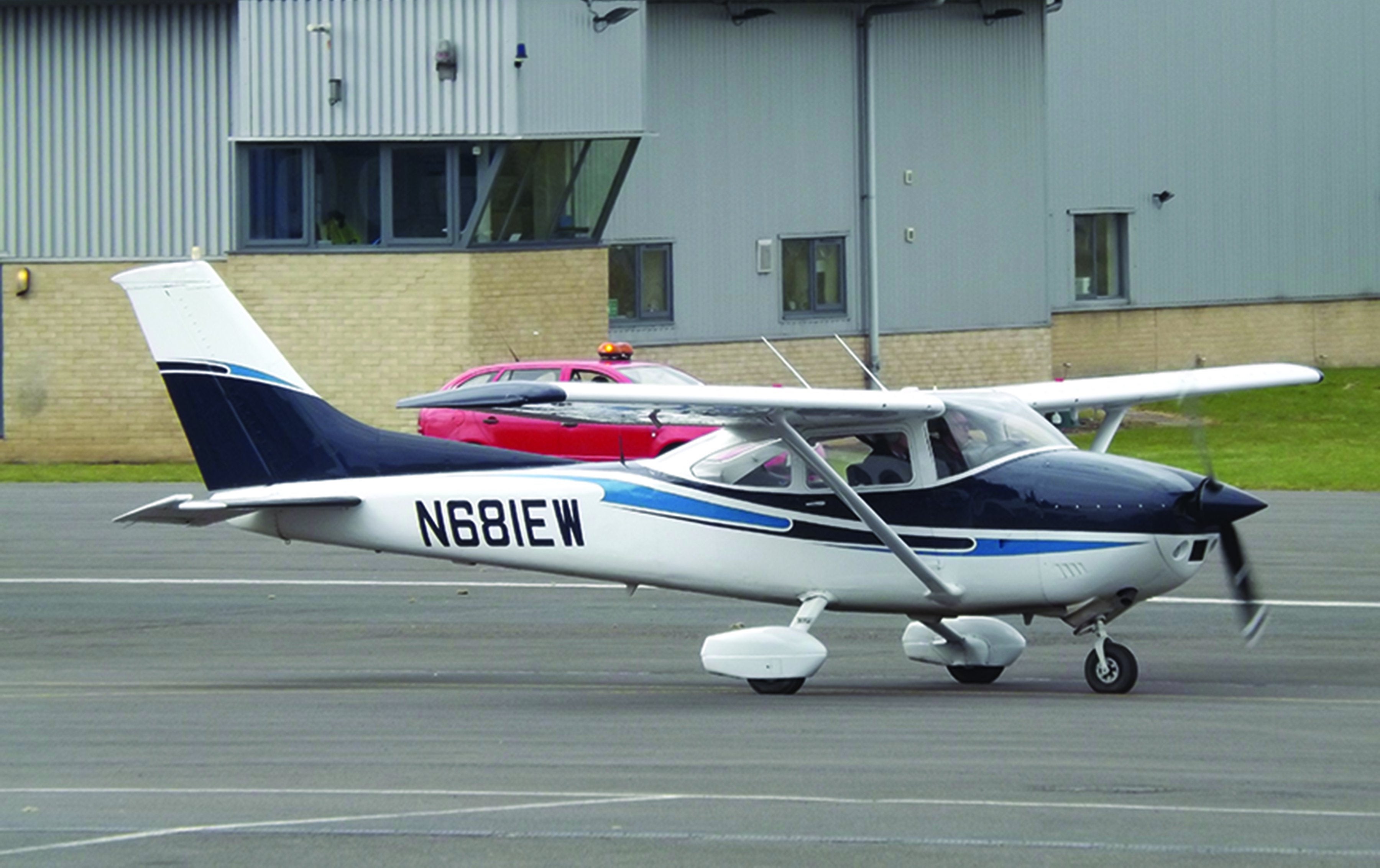

On October 15, 2016, at 1552 Pacific time, a Cessna 182D Skylane impacted a mountain peak near South Lake Tahoe, California. The solo private pilot sustained fatal injuries and the airplane was destroyed. Although the flight began in visual weather, instrument conditions prevailed in the area near the accident site. The flight departed Winnemucca, Nevada, about 1320, with a planned destination of Jackson, California, a distance of 205 NM.
At 1450, about the time the airplane would arrive in a no-wind situation, the pilot sent his wife a text message stating his groundspeed was “79 knots.” Around 15 minutes later, the airplane’s groundspeed had slowed to about 60 knots, according to ATC radar. By 1522, the accident airplane was 12 miles south of Reno, Nevada, cruising at around 10,500 feet MSL. Over the next 29 minutes, ATC made at least four attempts to contact the pilot but no response was received. Radar data revealed the airplane crossed the western shore of Lake Tahoe (elevation 6229 feet) at 1543, within eight miles of peaks reaching 9983 feet.
It then began veering left and right, with accompanying oscillations in altitude between 10,100 feet and 10,900 feet MSL. The last 96 seconds of radar data show the airplane descended from 10,800 feet to the last recorded altitude of 9700 feet about ¾-mile northeast of a 9311-foot summit. Radar contact was lost at 1551. The flight was about 50 miles from its destination airport.

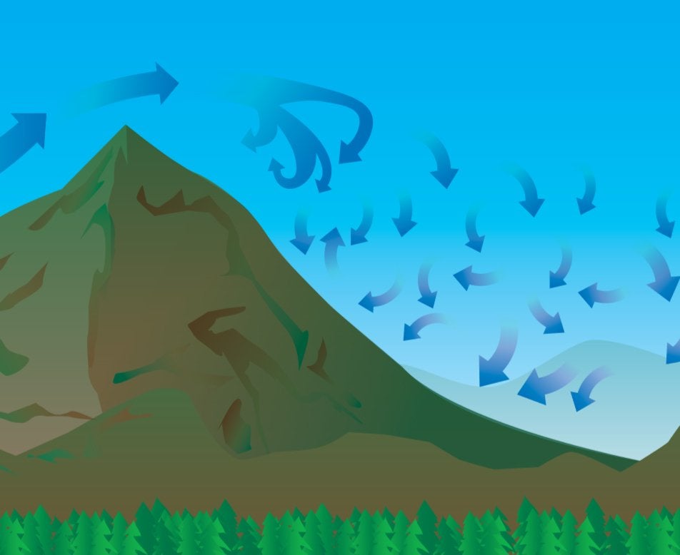

Mountain Waves
The FAA’s FAASTeam, quoting the Colorado Pilot’s Association—who should know—offers these tips for dealing with mountain waves:
  • If the winds crossing the mountains are greater than 25 knots, turbulence, updrafts and downdrafts may exceed aircraft limitations.
  • Consider crossing mountains only when the ceiling is at least 2000 feet above all ridges and passes along the route, to help reduce exposure to the most hazardous turbulence.
  • Good visibility, well above the basic VFR requirements (the FAA suggests at least 10 miles), is necessary since you will generally be using pilotage for navigating.
  • Mountain waves generate strong up and down drafts downwind from the ridges. The downdrafts in even moderate mountain waves exceed 1000 fpm.
  • Rotors are caused by the wind shear and rotating moment underneath the crest of a mountain wave. The rotors will cause severe or greater turbulence and must be avoided.
