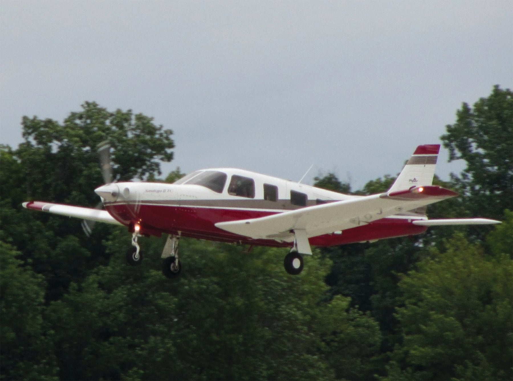

Aircraft Profile: Piper PA-32R-301T Saratoga II TC
Not accident aircraft.
