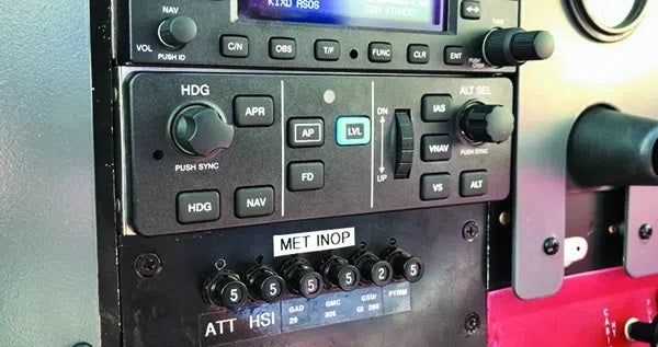

With entry-level retrofit EFIS finally affordably priced, it’s worth considering an autopilot installation at the same time. In fact, some autopilot systems rely on the data from an EFIS to do the driving, so you might be forced into a double upgrade. Garmin’s GFC 500 and 600 autopilots come to mind because the wide-reaching STC for these systems requires one of Garmin’s flight displays in the mix. This includes the G500/600 TXi PFD/MFD, the G5 EFIS and the GI 275 display.
The other benefit to connecting the autopilot to an EFIS might be the ability to operate all of the autopilot’s modes onscreen. This could eliminate the need for a separate autopilot control head, which saves time during the installation. Integrated systems like the Dynon SkyView Certified suite and Garmin G3X Touch have full autopilot integration within their displays, with an option for an electromechanical control head. More standalone interfaces—like Garmin’s G5 flight instrument—can display autopilot mode annunciation and can be used to command climbs, descents and level-offs, while also displaying autopilot command bars.
