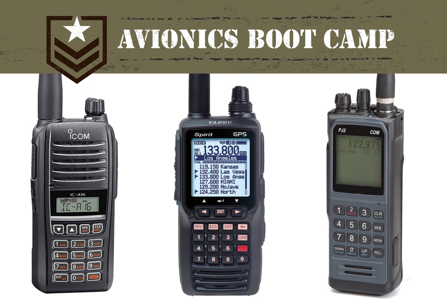

ICOM IC-A16, Yaesu FTA 750L, Sporty’s PJ2.

Icom’s A25N seems just the right size in the hand, has good ergos and a large display.

Icom (a staple in the land mobile com market) has enjoyed sizable success in the aviation market over the years with its line of portables, and the current flagship model is the $499 (street price) A25N. The “N” nomenclature means it has a built-in nav receiver, plus it also has Bluetooth. This radio has been a permanent extension of my own flight bag (and for use in the hangar) and has proven to be reliable, rugged and with far more features than I use. The radio ended up replacing the venerable Icom A22, which served me well—once talking me down from a real-deal electrical failure at dusk. I gave up on it when I couldn’t affordably source a replacement battery.
What I like most about the A25N is the build quality and chassis size. Weighing 13.6 ounces with the rechargeable lithium-ion battery and whip antenna attached, the waterproof Icom measures 5.8 inches high, 2.3 inches wide and 1.3 inches deep. It stands tall with the antenna attached, so you’ll have to remove the long antenna to fit the A25N into a dedicated radio pocket of a smaller flight tote, which I use. The antenna uses a quick-disconnect BNC connector, which makes it easy to saddle the radio up to an external antenna equipped with typical coax cable.
Where the early-gen A22 and other Icoms had 5 watts of transmit power, Icom built the current transmitters with 6 watts (every bit counts). When it’s not in service, I leave the radio plugged in to the standard desktop drop-in charger, and Icom sells a cigar lighter plug for powering it in the airplane. Still, I think it’s time Icom added a USB-C power port for on-the-fly charging from a power bank or panel USB power port. Battery endurance is spec’d at roughly 10 hours, but you can expect a lot less when transmitting—the duty cycle of the transmitter on portables eats power.
But the A25N is still efficient; I put it on the test bench and measured a 1.8-amp current draw while keying the transmitter for 10 seconds. If the radio is used for emergencies, I suggest buying the optional AA battery pack. I’ve grown to like the on-screen battery strength indicator, which works with the standard rechargeable cells and with the optional AA pack.

We covered the $199 Sporty’s PJ2 handheld in the March 2020 issue and also in video, so we’ll summarize it here. Sporty’s set out to offer a radio that’s simply easy to use without a lot of bells and whistles. Made exclusively for Sporty’s by Rexon in Japan, the PJ2’s key features include standard headset jacks on the top of the chassis so you won’t need a separate adapter to plug in, a USB-C plug-in for backup power input, and an AA alkaline battery pack.
Sport’s PJ2 (left) and SP-400 (right).
But even for the low price, the radio seems to have just enough features that buyers might expect. It will store up to 20 frequencies and has a last-frequency flip-flop (handy when the radio is used as a primary.) It also has NOAA’s weather channels. I’ve been using the radio for a year and find it stone simple to use—turn it on, key in all six digits of a frequency, and the radio will automatically tune it without you having to press the enter key. There’s also a single button to flip one frequency to the standby window like you find on a panel radio.
The simplicity continues throughout the chassis and feature set. There are dedicated volume and squelch knobs, an oversized backlit (and adjustable) display, simple oversized keys and a transmit/receive indicator light to guard against a stuck microphone.
In the real world, the PJ2 is a decent performer, but like most portables it won’t talk the distance (it has a 5-watt transmitter) without an external antenna. Its receiver sensitivity is quite good, able to pull in a signal almost as well as some panel radios. Connect the radio to an external antler and it should perform quite well.
Sporty’s PJ2 gets high marks for direct headset plug-in without an adapter.

The Yaesu brand is no stranger to portable transceivers, excelling with products for the amateur radio market. My Yaesu Ham HT rig from the early 1990s still works, and the company has been selling aviation handhelds for a while. The company’s Vertex Standard line of land mobile equipment (which included airband transceivers) was taken over by Motorola during a division merge. Yaesu continues to manufacture the aviation radios, but dropped the Vertex name.
Yaesu FTA-550 (left) and FTA-250 (right).
The flagship is the FTA-750L (street priced at $379), which has a 66-channel built-in GPS engine, a VHF nav receiver with VOR and ILS, and a compact chassis with a lot of features packed inside. The waterproof (PIX5 rated) chassis measures 5.2 by 2.4 by 1.3 inches and sports a 1.7 by 1.7-inch full dot matrix, adjustable backlit LCD display. It’s a mediocre performer in bright sunlight, although it does have a contrast adjustment for some tweaking. The 750L is powered by a high-capacity Li-ion battery pack, and also accommodates a six-AA alkaline battery tray.
