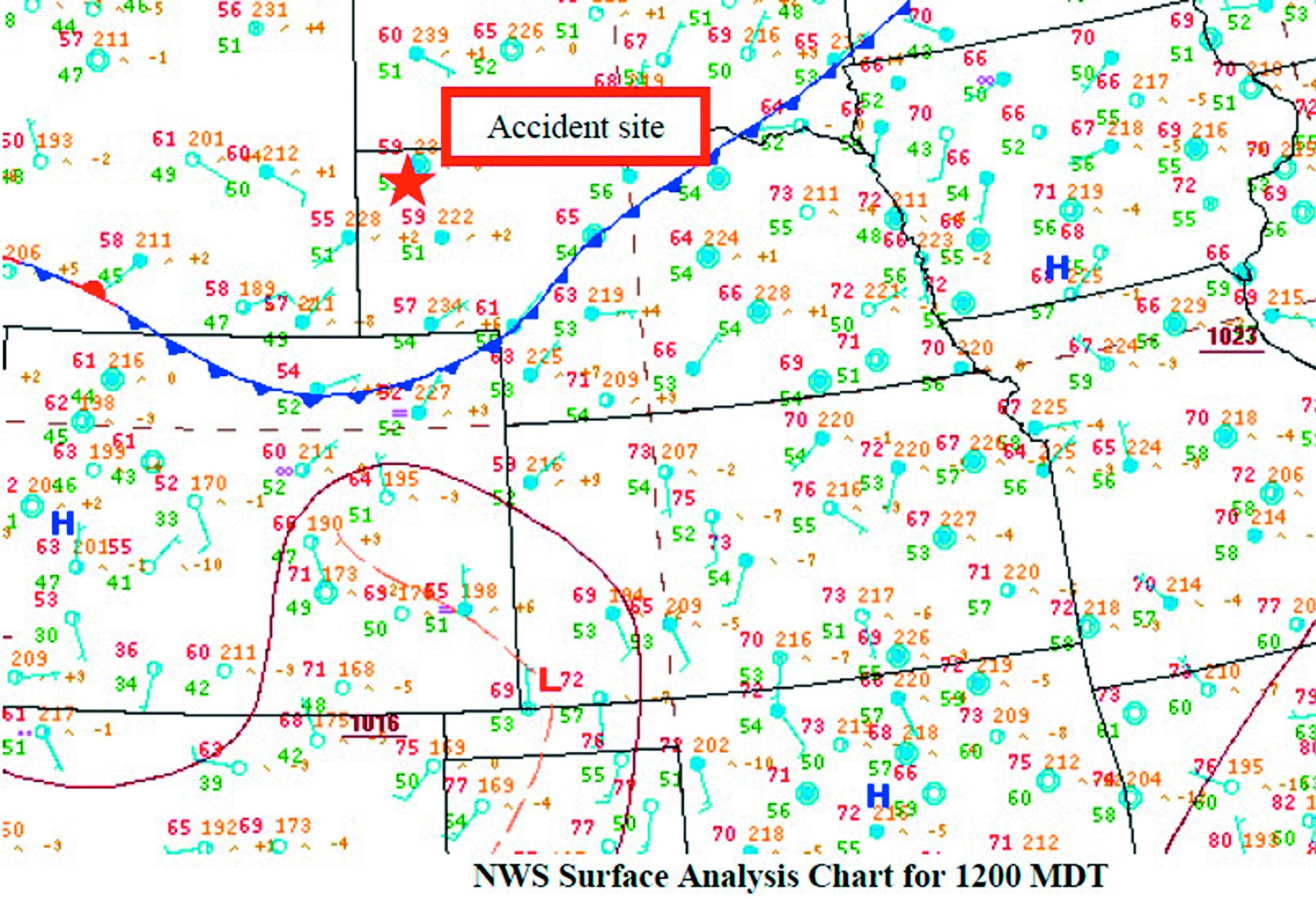

The local TAF forecasted the weather as winds from the east; visibility greater than six miles; scattered clouds at 700 feet, and an overcast ceiling of 2000 feet. The most recent AWOS (17 minutes before departure) reported calm winds; nine miles visibility; a broken ceiling at 1500 feet and an overcast ceiling at 3400 feet.

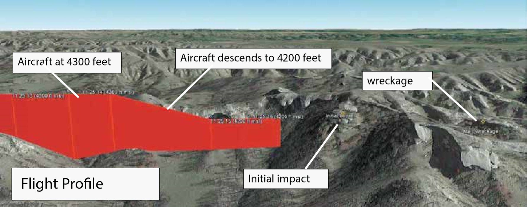

At this point the aircraft was heading south. Radar track data indicated the plane had a groundspeed of 145 knots, and it was flying at 4200 feet MSL, or approximately 1000 feet AGL. The flight continued south at speeds between 135 and 155 knots over the ground, with the altitude varying between 4200 and 4400 feet MSL.

Using ADS-B data it was determined the aircraft encountered rising terrain, 900 feet above the departure airport elevation, 10 miles south of KCDR. The Bonanza hit treetops and a ridge line completely destroying the aircraft on impact. Day IMC prevailed at the accident site.
A witness, who was working outside nearby, noted the weather throughout the morning had been light precipitation, mist, fog, and low clouds that obscured the surrounding ridge lines. According to investigators, the pilot likely encountered IMC just before hitting the ridge line. As so often seems to happen, the witness also noted the weather improved shortly before noon.

Often a lack of awareness of the local topography is the culprit. Abrupt rising terrain can easily be masked by clouds and fog. Descending cloud bases are often not easily discernible, and the pilot reacts to the encroaching mist by gradually descending to stay visual.
In this accident, the raising terrain as depicted in the accompanying illustration is not subtle, but rather rapidly raising. That the aircraft impacted after descending from 4300 feet to 4100 feet, it seems plausible that he was reacting to the lowering ceiling.
