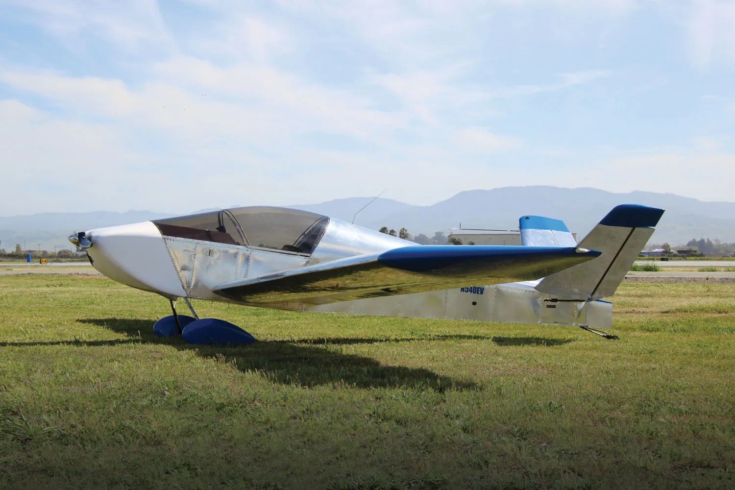

The Xenos (gas or electric) sits wide on the ramp. Make sure you know where your wingtips are as you taxi.

Gabriel DeVault’s Xenos started out like any Xenos—a pile of aluminum and a set of plans from Sonex Aircraft, LLC. The original owner made one significant change that we could see: Instead of pulling the standard dome-head skin rivets, he dimpled the entire airplane for flush pulled rivets, a nice touch that can be argued as excessive or just compulsive in the drag reduction department for an airplane designed to fly around at 80 or less knots most of the time. But it does make for a smooth and pretty airframe.
Gabriel picked up the project when it was ready for systems and powerplant—the perfect spot to begin an electric installation. As a founder of the electric motorcycle manufacturer Zero, he used his 10 years of experience in designing electric power systems and went straight to his roots: He purchased a 2018 Zero motorcycle, used. Unfortunately, but understandably in this litigious world, Zero’s lawyers don’t want the company to be associated with aviation in any way, so you can’t go to them and buy their custom power system components directly. But they don’t have any say in what you do with used parts.
According to Gabriel (and a recent search of used motorcycle websites), you can purchase a suitable donor bike for somewhere around $10,000–$14,000. This is a significant upcharge over what you would pay Sonex for their AeroVee engine, but significantly less than what you would pay for a suitable Rotax or Jabiru—and it’s downright cheap compared to a small Lycoming or Continental. The donor bike will be stripped to provide the motor, battery package, controller and engine monitor display. The package is cleverly designed with a Bluetooth interface that can be used with monitoring apps on your smartphone or tablet. It also has the capability to provide auxiliary 12-volt power that in the bike would be used for consumer accessories. But in the airplane it can power radios, transponders and EFIS displays—just like that alternator you’d find on an aircraft motor.
The basic power package is mounted to a custom engine mount that Gabriel designed and had built. It incorporates the firewall end of the mount supplied by Sonex to retain the landing gear leg sockets and then consists of welded tubing to support the battery and motor. It could be argued that since the battery is the significantly weighty part of the power package, it is really a battery mount that also holds the relatively tiny motor and reduction drive in place. The reduction drive is a simple spindle with a pulley to mate with the cogged belt coming from the motor pulley, as well as a prop hub to which you can bolt the prop. Gabriel is using a Prince prop that came with the Xenos airframe from the original builder. There is nothing custom about it for the electric power in this configuration.
The re-drive unit consists of the white powder-coated structure, the hub, belt, pulleys and motor mount. The finned motor comes straight out of the motorcycle.
The entire power package weighs in at about 250 pounds, according to Gabriel, and replaces the standard motor and fuel system. With the battery hanging forward of the firewall and the fuel tank removed, the weight and balance comes out very close to a standard Xenos—a major consideration for anyone building with an alternative powerplant. The battery accounts for about 180 pounds of that weight, with the rest being in the monitor, controller and wiring. There are some pretty large wires to conduct that much power around, but they are short. The batteries are 102-volt lithium-ion, the same as used in the motorcycles. And despite the odd rumors we have all heard, there are no reputable reports of Zero motorcycles going up in flames.
