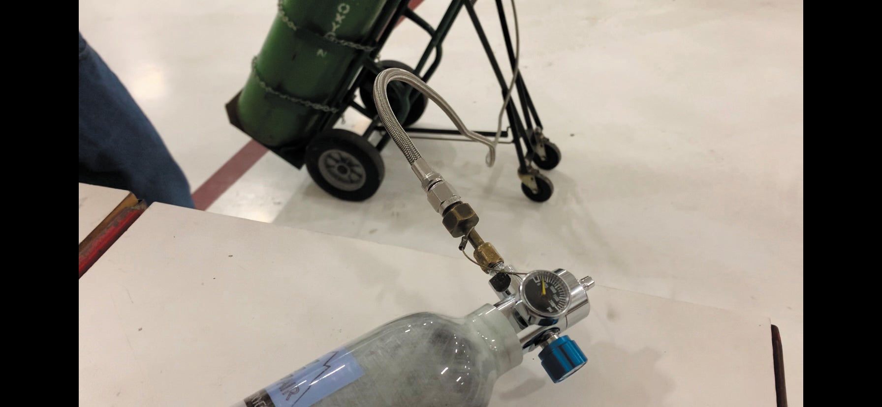

That’s our 47-liter Aithre long-term-test O2 cylinder on the refill bench at a shop we transited. We didn’t have the right transfiller hardware, and never could get the cylinder to top off. We solved that wart by buying the $270 Euro Type DIN 477-9 to AN-800 adapter.
