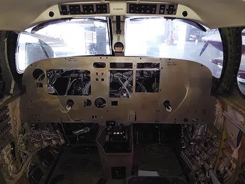

That's a Piper Mirage panel in the works at Sarasota Avionics in Florida. Planning and drawing it out first is a critical first step in a new panel retrofit.

Most existing round-gauge airplanes have instrument panels that simply weren’t designed for big-screen displays. That means your shop will likely be tasked with cutting a new metal panel to make it all fit. And even if your proposed upgrade doesn’t require lots of cutting, an avionics project is the opportunity to upgrade the panel’s aesthetics from, in some cases, 1970s or earlier designs. Replacing the brittle, cracked and faded Royalite plastic overlay for a cleaner, more durable metal panel has benefits. Plus, the right paint choice can improve the panel lighting and complement a new cabin interior.
But to get there, your shop will tear the airplane to its core, removing, rewiring and installing large wiring bundles. There’s paint, placarding and if the modification alters the structure, the shop will need to get FAA approval. Yes, these are big invoices and in this article we’ll look at why it takes more planning, downtime and investment than you might appreciate. Truth is, skilled shops are turning out refurbished panels that are better than some OEM ones.
