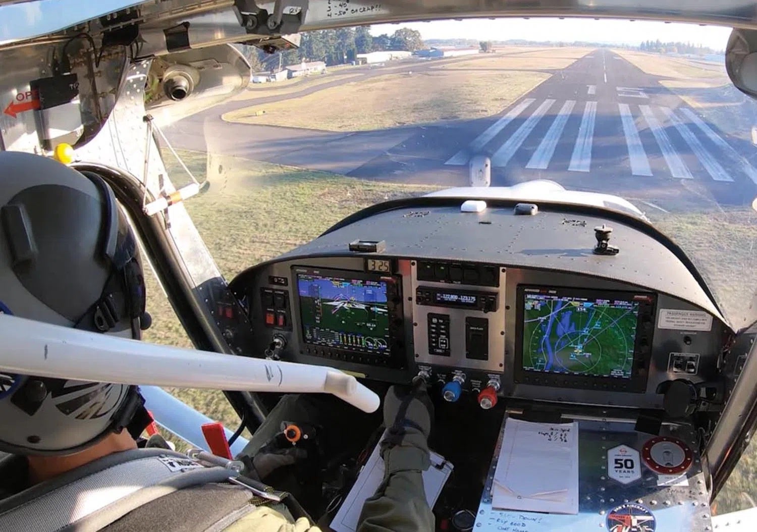

Task-based Phase I flight testing offers the opportunity to reduce the duration of the process, from first engine start to release into the world of Phase II flying.
