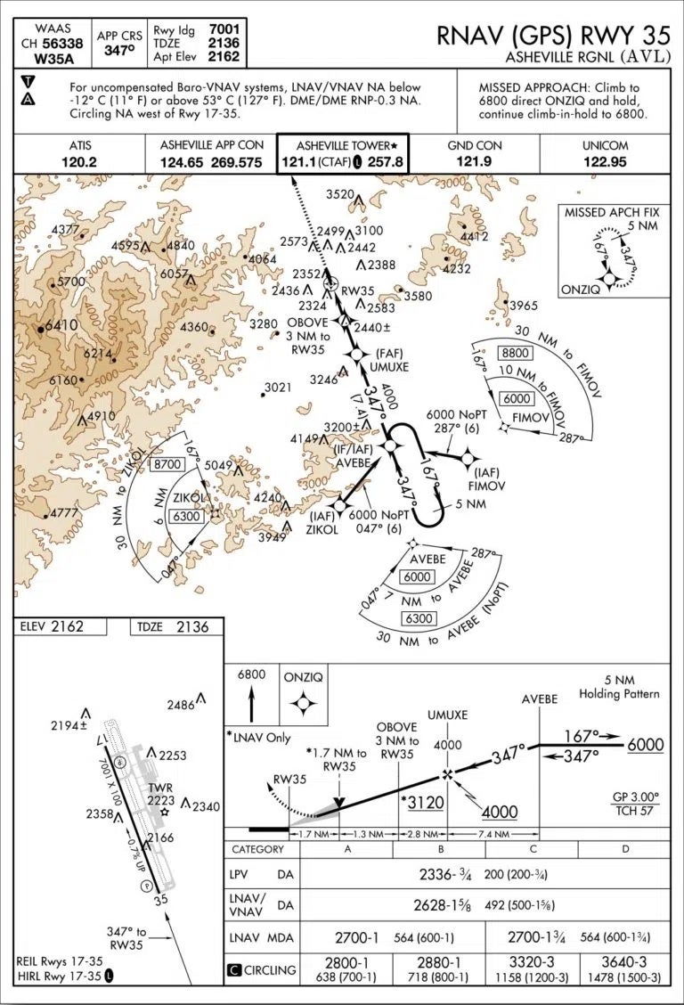

The RNAV (GPS) procedure for Runway 35 at Asheville Regional also offers 200-feet/¾-sm minima. But that’s where the similarities begin diverging. You’ll start the approach at a higher altitude, which may not be a good thing if icing exists, but you’ll enjoy the benefits of a straight-out missed approach procedure, if it comes to that. If you have less-than-LPV capability, this procedure might also be better for you instead of the localizer-only minima on the ILS.

If your GPS navigator doesn’t have LPV capability, LNAV/VNAV is your next best choice, as usual. You can get down to 492 feet above the touchdown zone, which is better than the ILS procedure’s localizer-only MDA even when OBOVE is identified. With LNAV only, you’re in localizer-only territory, with one exception: You don’t have to identify OBOVE to get that MDA.

That’s pretty much it for the equipment requirements. If everything’s working, the ILS and LPV minima are the same, while the RNAV procedure offers lower MDA choices over the localizer-only minima when you can’t identify OBOVE. If you can use the OBOVE minima, it’s another toss-up. The worst case is if you only have a single VOR receiver lacking a glideslope. If so, you’re basically stuck with VFR minima. And you still need an ADF or IFR-approved GPS to identify the Broad River NDB.

But let’s presume you’re arriving from the south and the winds or some other operational consideration make landing on Runway 17 your preference. Rather than use the straight-in minima associated with either the ILS or the RNAV, you can break out and circle to 17 if the ceiling is high enough. Maybe.
Right off, you need to know that circling to the west of Asheville’s single runway at night isn’t authorized. If you’ve ever been to the airport in the daytime, you’d know why: There are some hills out there, fairly close to the runway, that you don’t want to tangle with. In fact, we’d strongly suggest not circling to the west at Asheville even in the daytime, although doing so is legal.
If you want to circle to land on Runway 17 at Asheville, both procedures offer the same minima: 2800 feet MSL is your Category A MDA, presuming you can identify OBOVE when using the localizer-only procedure, and the same MDA is available when using the RNAV approach. The only real caveat harks back to an airplane with only a single working VOR receiver and no glideslope: Without identifying OBOVE, you’ll be stuck with a 3100-foot circling MDA since there’s no non-GPS approach option for Runway 17.
Finally, note that the Runway 17 threshold is a full 50 feet higher than the one for Runway 35—the planview shows a 0.7-percent slope between the two. If you need the full 7000 feet of runway, maybe you shouldn’t be using 17 anyway. Wind conditions probably will be your guide.

Because Asheville is in the mountains, its weather can be unpredictable for out-of-towners. With a 200-foot DH/DA for either approach to Runway 35, you’ll likely get in the first time. But the missed approach instructions for the two procedures differ in what could be significant ways for you.
The easiest miss at Asheville is associated with the RNAV procedure. It calls for a straight-out climb, to 6800 feet MSL, to the ONZIQ intersection/fix. ONZIQ forms an intermediate/initial approach fix for the RNAV Runway 17 procedure, and is 13.6 NM from its threshold. That makes it roughly 15 NM from the missed-approach point (MAP) on the approach to Runway 35. Presuming you’re shooting the LPV portion of the RNAV procedure and descend all the way down to 2336 feet MSL before initiating the miss, you’ve got 15 NM to climb to ONZIQ’s 6800-foot minimum holding pattern altitude. At 120 knots groundspeed in the climb, it’ll take you 7.5 minutes to reach ONZIQ. You’ll need roughly a 600-fpm climb rate to reach 6800 feet at ONZIQ, or you can continue climbing in the hold. Because ONZIQ is straight-out on the miss, it might be preferable to you if there’s a chance of going missed on either the ILS or the RNAV approach.
Did I mention Asheville is in the mountains? It can get cold there in winter, and airframe icing often is a consideration. In such situations, climbing to 6800 feet MSL on the miss may not be your first choice. If it’s not, the ILS procedure may offer a better deal if there’s a likelihood of missing. It requires climbing only to 5500 feet MSL, but does involve a climbing right turn after reaching 2800 feet. The holding fix for the miss, JUNOE, is 16 NM from Runway 35’s threshold as the crow flies. You’ll need a climb rate of roughly 400 fpm to reach it.

Another part of the equation is the minimum safe altitudes the two procedures depict. Within 25 NM of Broad River, the MSA is 7700 feet MSL. But the RNAV procedure’s chart shows only 6300 feet as far as 30 NM south of the AVEBE initial approach fix, but you’ll still need 6000 feet crossing it. Much higher MSAs exist in other directions.
