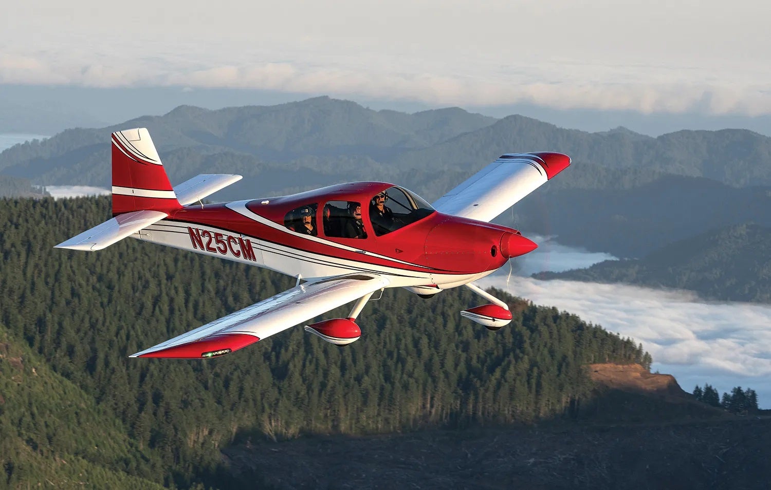

We choose to build aircraft for many reasons. There are elements of challenge to the project, of course, learning to master the details of project management while keeping the emotions in check. (As best we can.) At the end of which we find ourselves basking in our glory or deeply concerned for our sanity; sometimes a mixture of both. Most builders have some instigating reason to build beyond “education and recreation” that loosely centers on a mission: What do we want our dream airplane to do? How does it open doors in my flying? What can I do after the project is complete that I can’t do now? (And: Where did I put my 3/8-inch socket?)
For Mark Easton, whose RV-10 you see on these pages, the answer was actually quite simple: He wanted a family airplane that was safe, one that he knew he could complete but also one that embodied some of the latest thinking in aviation. Technology was a driver for Easton, easily explained by his choice of automobile (a Tesla) but also his office. As in the right front seat of a Boeing 787 Dreamliner for American Airlines. It stands to reason, then, that Mark’s comfort with the latest in airliner tech would migrate to his Van’s RV-10 project.
Easton’s RV-10 began life as a “slow-build” kit that morphed into an airplane in a four-car garage near Portland, Oregon. Room for the wings came from stacking (left) while the fuselage “canoe” was completed (right). He’s proud that one car got to live inside the whole time.
But it actually started well before that. “I’ve wanted to build an RV since I was a kid. You know how you’d see those ads in the back of the magazines, ‘You can build your own airplane!’ Although no one in my family was into aviation, I always thought it would be cool to build my own airplane,” Easton says. Nearer to his current build, he says he’d narrowed it down to the RV-10 or the RV-14, “two of the newest, most modern kits Van’s makes,” and eventually landed on the 10. “I didn’t want to decide which of my two kids would get to go flying.”
