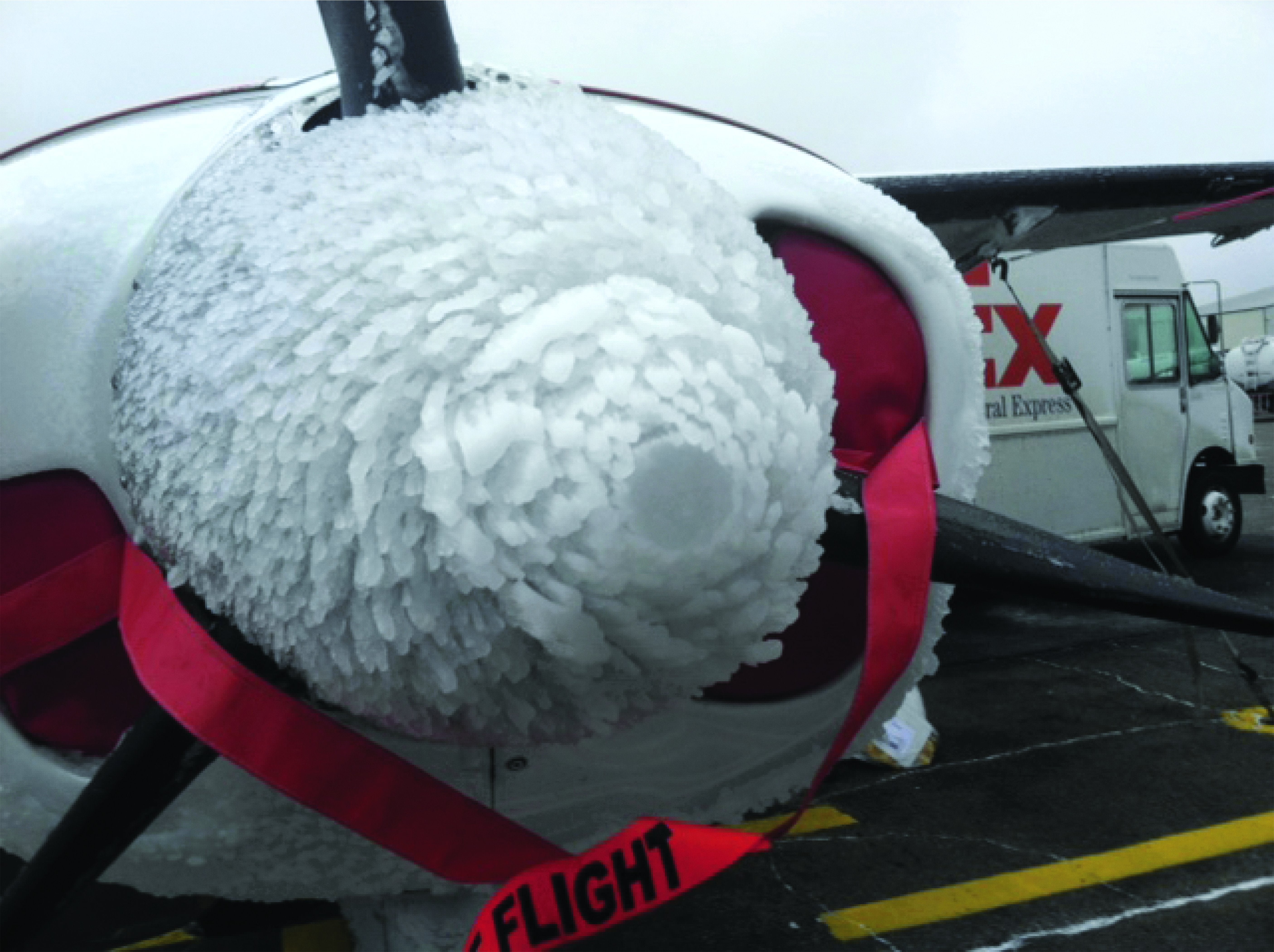

More Power Is Better
Rationalizing that it’s better to have extra power than to be able to remove ice, is correct…to a point. Extra power may allow you to climb through an icing layer (legally or not), but eventually you have to come back down. If you encounter icing in descent and/or on approach, the extra power won’t help.
Wet, slushy snow or volumes of clear ice can block an engine’s air inlet, reducing power. Alternate induction air sources typically are in the low-pressure area of an engine compartment. If the inlet air filter clogs with ice or snow, the alternate induction air pressure is low enough that the turbocharger may not provide full power. Some airplanes will experience reduced manifold pressure at full throttle when drawing induction air through the alternate air door.
Further, an iced-up propeller becomes less efficient at converting twist into thrust—it’s an airfoil, too—and the wings and tail become aerodynamic unknowns. What has been said about the effects of density altitude on airplane performance goes for airframe ice accumulation as well—you can’t turbocharge the propeller, wings or tail. Rationalizing that power overcomes ice does not hold up if the pilot is unable to escape to an area where ice is shed before descent and landing. By itself, turbocharging is not an ice-avoidance strategy.
