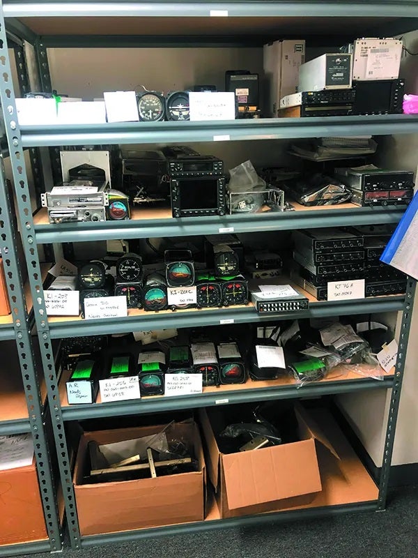

That's a typical used equipment shelf at a busy avionics shop. Look closely - the two shelves packed with traditional flight instruments are proof that glass panel upgrades are on the rise.
