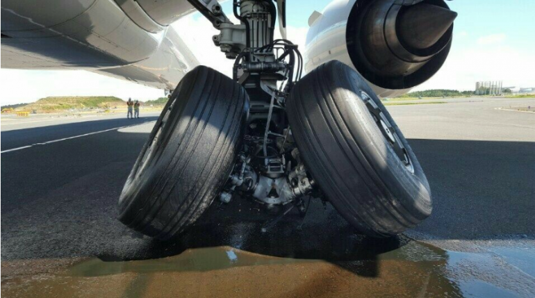

  • A Korean Air Boeing 777-300 experienced a broken main landing gear axle while taxiing at Narita Airport, causing the rear wheels to fold and the aircraft to halt.
  • There were no injuries to passengers or crew, who deplaned using airstairs after the incident.
  • Japanese authorities have classified this unusual event as a "serious incident" and are conducting a full investigation, likely prompting other Boeing 777 operators to inspect their landing gear.
Operators of Boeing 777s will likely be taking a close look at the landing gear on their aircraft after an unusual incident at Narita Airport in Japan on Friday. A Korean Air 777-300 was taxiing to the gate when the axle holding the rear set of wheels on the main gear broke. The wheels folded up onto themselves and the aircraft ground to a halt. The rear set of wheels touch first on landing because the gear is articulated at the strut and angles rearward in the air. There were no injuries but the passengers and crew had to leave via airstairs.
There was no indication the landing was particularly hard although newsinflight.com quoted a passenger as saying “the right side was tilted down when landing.” The Japanese transport ministry classified it as a “serious incident” and is doing a full investigation.
