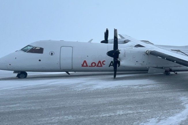

The pilots of a De Havilland Dash 8 cargo flight aimed to reduce the risk of runway overrun at a remote northern Canadian airstrip last spring. Instead, they encountered a downdraft and landed short, shearing off the left main landing gear and damaging the aircraft, according to a newly released Transportation Safety Board of Canada (TSB) report.
On March 30, 2024, the Air Inuit DHC-8-314, operating as a daytime cargo flight under instrument rules, departed La Grande Rivière Airport (CYGL) bound for Kangiqsujuaq (Wakeham Bay) Airport (CYKG) in northern Quebec. The two pilots and cargo agent onboard thankfully did not receive any injuries, despite significant damage to the Dash 8 on landing.

Following the downdraft, the Dash 8’s wheels struck a gravel mound about 220 feet before the runway threshold. The left wheel touched down roughly five inches below runway level, and the impact caused the left landing gear strut cylinder to fracture. The assembly separated from the aircraft as it bounced onto the runway, coming to a stop 2,100 feet down the strip. The left nacelle, propeller, and fuselage also sustained damage.
The TSB said it found the accident resulted from a combination of factors. These included the selection of a runway threshold aiming point, the final descent below glide path, and wind-induced downdrafts common to the rugged terrain surrounding CYKG.
