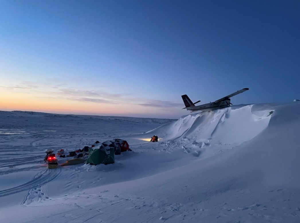

The Transportation Safety Board of Canada (TSB) released its final report into a December 2023 controlled flight into terrain (CFIT) accident on Thursday. The crash involved an Air Tindi de Havilland DHC-6 Twin Otter that impacted terrain near Lac de Gras, Northwest Territories.
Findings concluded that the crew’s decision to continue the flight in worsening weather conditions played a central role in the event.
The VFR flight struck a snow-covered hill just southeast of the crew’s intended landing site. The aircraft engaged in multiple approach attempts to the site in poor visibility ahead of the crash, which resulted in serious injuries to two passengers, while the remaining occupants, including both pilots, walked away with minor injuries. The airplane was substantially damaged, though there was no post-impact fire.

The accident occurred on Dec. 27, 2023, when the wheel-ski-equipped Twin Otter departed Margaret Lake for the Lac de Gras road camp with two crew members and eight passengers on board. The flight was conducted as part of Air Tindi’s day VFR air taxi operations in support of northern mining activity.
Weather conditions in the region were already challenging and continued deteriorating over the course of the flight. Visibility decreased to approximately one-half statute mile in blowing snow, with ceilings estimated between 300 and 400 feet agl. Despite these conditions, the crew elected to proceed toward Lac de Gras, relying on prior experience operating successfully in similar weather, the report said.
Upon arrival in the vicinity of the road camp, the flight crew was unable to clearly distinguish the frozen lake surface from the surrounding terrain. Over the next several minutes, they conducted four improvised approach attempts, descending at times to below 50 feet agl while attempting to visually acquire the landing area.
During the final approach, the aircraft again descended below 50 feet agl when the crew lost visual contact with the terrain. Both pilots saw a hill directly ahead only seconds before impact. Although full power was applied and both pilots pulled aft on the controls, the airplane struck the terrain approximately two seconds later, according to the TSB’s reconstruction of the event.
