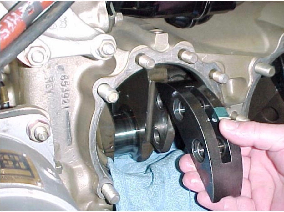

The total number of engines affected is about 2000, but Continental said it’s unknown how many of those are beyond 200 hours. Warranty performance and reimbursement is described in this service bulletin released on February 13. On many of its engines, Continental uses moving counterweights to reduce torsional loads on the crankshaft. The weights are held in place on the crankshaft with a pin arrangement secured with snap rings. The weights counteract torsional loads by sliding across a small range of movement. The defect, says Continental, is due to an assembly error, not an incorrectly manufactured part. As described in the service bulletin, the weights and snap rings can be accessed by removing cylinders without the need to split the engine case or remove the engine from the airframe. The photo in this story depicts a counterweight removed, but this service instruction only requires checking the snap ring, not removing the weights. All of the engines in question are six-cylinder models.
