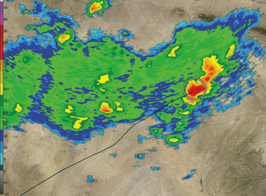

Flight 56 ground track against NWS radar imagery [Credit: NTSB Report]

Investigators noted the flight crew had discussed the potential for turbulence along the route during pre-departure briefings and initially observed only light cirrus clouds as the aircraft climbed. At flight level 370, air traffic control assigned the crew to a northerly heading. Shortly after turning, the aircraft experienced an overspeed event, disengagement of the autopilot, and a sequence of climb and descent cycles lasting about 2.5 minutes. Preliminary flight data recorder information showed vertical acceleration peaks ranging from 1.75 g to -0.5 g, with pitch variations of up to 10 degrees nose up and 5 degrees nose down.
The report notes there was a convective SIGMET in effect at the time with tops above flight level 450. Crew members declared an emergency and coordinated with dispatch while assessing onboard injuries. The aircraft itself sustained only minor damage to its interior.

  1. As a retired ATC familiar with radar weather display on ATC scopes, I can’t fathom a controller not seeing on his radar what is shown on the image in this report, and not issuing a vector around that big red spot. Maybe a current radar controller can explain the discrepancy?

  3. Yes, the controller can issue an advisory but it’s the pilot’s job to fly the plane. By that, I’m saying look out the window and use your radar. With that kind of pre-departure weather brief, I’d be monitoring my radar all the time.

  5. This is clearly on the flightcrew. At that altitude and in that airspace they could have asked for deviations in any direction, to avoid the convective activity they ended up flying into, and ATC would have approved it. There are several sources of information available to a flightcrew regarding convective activity along their route of flight. Modern aircraft have excellent on board weather radar and Part 121 carriers, like Delta, have a dispatcher monitoring each flight, providing updates on their routing including sending sigmets and ride reports. Armed with that information the crew would then tell ATC how they wanted to avoid the weather ahead. The NTSB report stated the crew flew through the area with the heaviest, all red, radar returns. Maybe they thought they could top it, but that is almost always a very bad idea. The fact that they didn’t have the seatbelt sign on is also very hard to understand . Since this flight had an augmented crew it will be interesting to find out who was actually on the flightdeck when this happened. In any case the responsibility for operating this flight rests solely with the flightcrew, not ATC.
