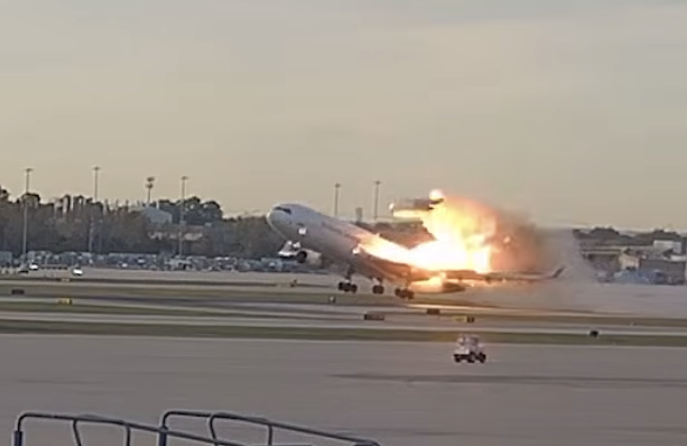

Airport surveillance video showed the aircraft’s left engine and pylon separated shortly after takeoff rotation. An NTSB animation described fatigue cracking in the outer race of a spherical bearing in the left pylon aft mount, followed by cracking and fracture of the mount lugs. The video concluded with the airport security footage showing the full detachment sequence. Although the aircraft climbed to about 30 feet AGL, it struck buildings and terrain south of the runway.
