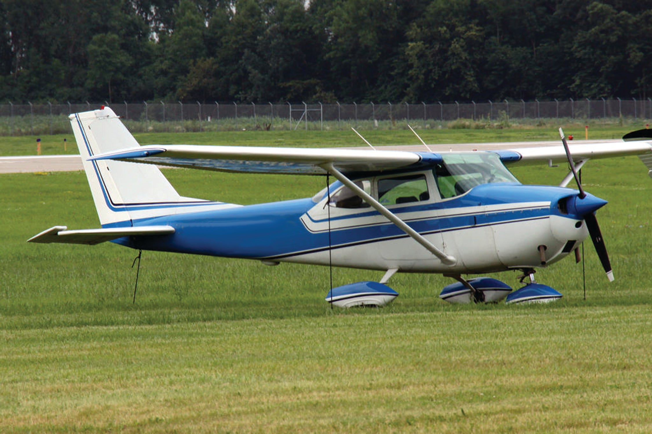

Aircraft Profile: Cessna Model 172H Skyhawk
Engine: Continental O-300-D
Empty Weight: 1330 lbs.
Maximum Gross Takeoff Weight: 2300 lbs.
Typical Cruise Speed: 114 KTAS
Standard Fuel Capacity: 42 gal.
Service Ceiling: 13,100 feet
Range: 515 NM
VSO: 43 KIAS
