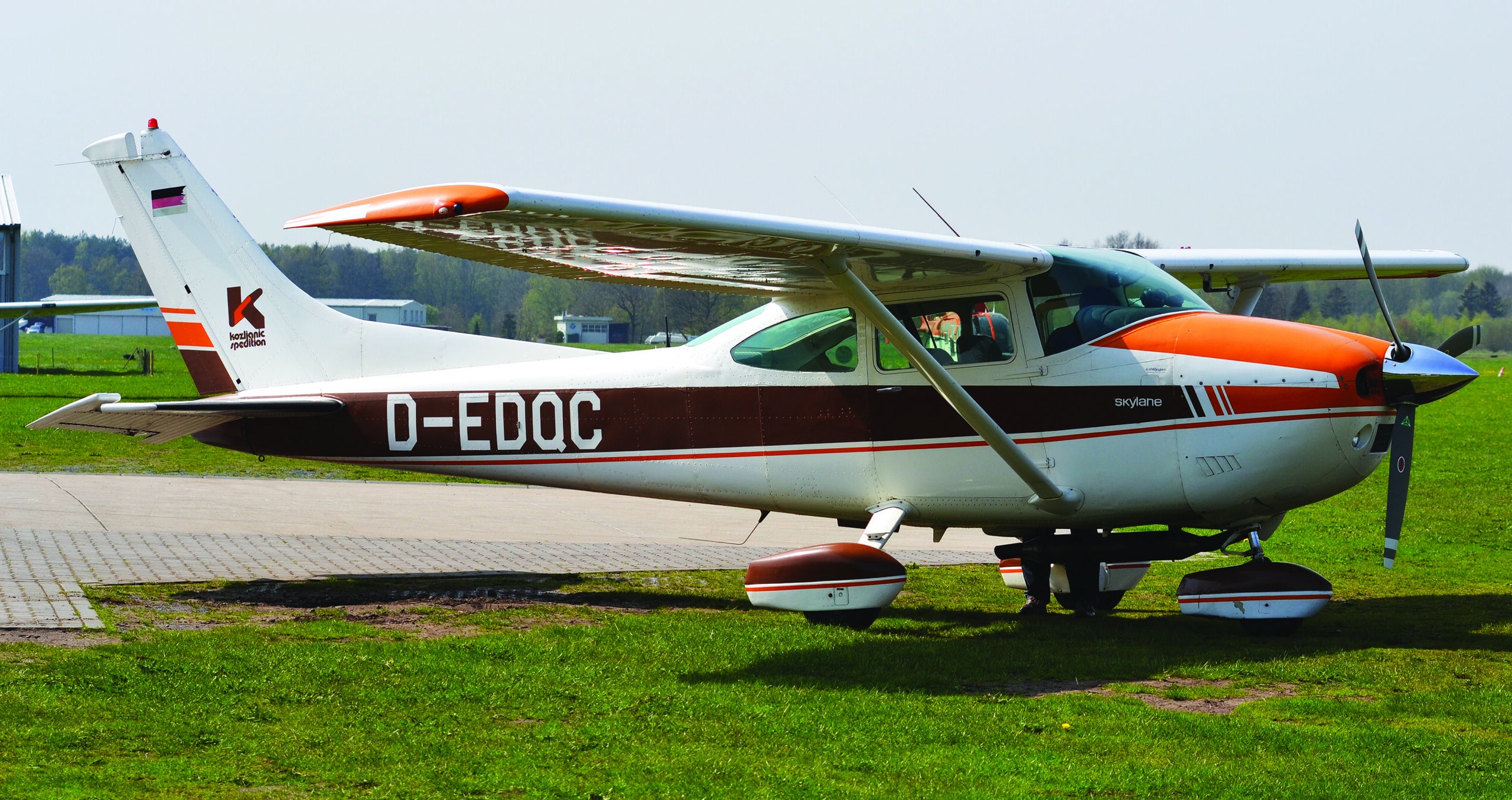

Not accident aircraft. Image: Huhu Uet

Aircraft Profile: 1979 Cessna 182Q Skylane
OEM Engine: Continental O-470-U
Empty Weight: 1754 lbs.
Maximum Gross Takeoff Weight: 2950 lbs.
Typical Cruise Speed: 140 KTAS
Standard Fuel Capacity: 92 gal.
Service Ceiling: 16,500 ft.
Range: 817 NM
VS0: 50 KCAS
