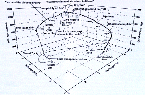

At 1407:22, the departure controller instructed flight 592 to “turn left headingthree zero zero join the WINCO transition, climb and maintain one six thousand.” Thefirst officer acknowledged the transmission. At 1410:03, an unidentified sound wasrecorded on the Cockpit Voice Recorder (CVR), after which the captain remarked, What wasthat?” According to the Flight Data Recorder (FDR), just before the sound, theairplane was at 10,634 feet mean sea level (MSL), 260 knots indicated airspeed (KIAS),andboth engine pressure ratios (EPRs) were 1.84.
At 1410:15, the captain stated, “We got some electrical problem,” followedfive seconds later with, We’re losing everything.. At 1410:21, the departure controlleradvised flight 592 to contact Miami Center on frequency 132.45 MHz. At 1410:22, thecaptain stated, We need, we need to go back to Miami,. followed three seconds later byshouts in the background of “fire, fire, fire, fire.” At 1410:27, the CVRrecorded a male voice saying, “We’re on fire, we’re on fire.”
At 1410:28, the controller again instructed flight 592 to contact Miami Center. At1410:31, the first officer radioed that the flight needed an immediate return to Miami.The controller replied, “Critter five ninety two uh roger turn left heading two sevenzero descend and maintain seven thousand.” The first officer acknowledged the headingand altitude. According to a pre-existing agreement between the FAA and ValuJet, airtraffic controllers used the term “Critter” as a callsign when addressingValuJet aircraft. “Critter. referred to the logo of a cartoon airplane painted on theValuJet fleet. The peak altitude value of 10,879 feet MSL was recorded on the FDR at1410:31 and, about 10 seconds later, values consistent with the start of a wings-leveldescent were recorded.
According to the CVR, at 1410:36, the sounds of shouting subsided. About four secondslater, the controller asked flight 592 about the nature of the problem. The CVR recordedthe captain stating “fire” while the first officer radioed, “uh smoke inthe cockp…smoke in the cabin.. The controller responded, “Rogers and instructedflight 592 to turn left when able to a heading of two five zero and to descend andmaintain 5,000 feet. At 1411:12, the CVR recorded a flight attendant shouting,”Completely on fire.”
The FDR and radar data indicated that flight 592 began to change heading to a southerlydirection about 1411:20. At 1411:26, the north departure controller advised the controllerat Miami Center that flight 592 was returning to Miami with an emergency. At 1411:37, thefirst officer transmitted that they needed the closest available airport. At 1411:41, thecontroller replied, Critter five ninety two they’re gonna be standing (unintelligible)standing by for you, you can plan runway one two when able direct to Dolphin [VOR] now. At1411:46, the first officer responded that the flight needed radar vectors. At 1411:49, thecontroller instructed flight 592 to turn left heading one four zero. The first officeracknowledged the transmission.
At 1412:45, the controller transmitted, “Critter five ninety two keep the turnaround heading uh one two zero.” There was no response from the flightcrew. The lastrecorded FDR data showed the airplane at 7,200 feet MSL, at a speed of 260 KIAS, and on aheading of 218 degrees. At 1412:48, the FDR stopped recording data. The airplane’s radartransponder continued to function; thus, airplane position and altitude data were recordedby ATC after the FDR stopped.
At 1413:18, the departure controller instructed, “Critter five ninety two you canuh turn left heading one zero zero and join the runway one two localized at Miami.”Again there was no response. At 1413:27, the controller instructed flight 592 to descendand maintain 3,000 feet. At 1413:37, an unintelligible transmission was intermingled witha transmission from another airplane. No further radio transmissions were received fromflight 592. At 1413:43, the departure controller advised flight 592, “Opa LockaAirport’s about 12 o’clock at 15 miles.”
The accident occurred at 1413:42. Ground scars and wreckage scatter indicated that theairplane crashed into the Everglades in a right wing down, nose down attitude. Thelocation of the primary impact crater was approximately 17 miles northwest of MIA.
3D flight path plot
