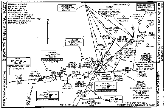

Acton Two Arrival
Let’s examine the Acton Two Arrival (AQN.AQN.2) for DF/W to seehow it can work. Let’s assume we’re flying a piston single ona short 50-mile trip coming into the D/FW area from Waco. Let’ssay we file 5000 feet, direct to our destination, Arlington, Texas.In case you’re wondering, there’s no chance we’ll get that routing.IFR traffic into DF/W is routed over one of four “gatepost”VORs that form a square around the metro area.
With that in mind, clearance delivery will come back with somethinglike this: “Cleared to the Arlington Airport, via Victor17 Acton, the Acton Two arrival, maintain 5000 feet, departurefrequency 135.2…” Pilots not accustomed to flying low-altitudeSTARs may be surprised by that clearance, since the STAR goesto small muni field with no tower.
Acton Two Arrival

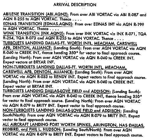

Step one is to make sure the STAR goes to your destination. Ifit doesn’t, you can’t get there from here, period. Step two isto forget about the picture and go to the text on the back ofthe page. For this particular STAR (and many others around Dallas)the map is a nightmare. The arrival description cuts through theclag, though. It lists various categories of aircraft: Turbojetslanding at Dallas. ..that’s not us. . .Non-turbojets landing atDallas…closer, but no cigar. Finally, under “All aircraftlanding at Arlington,” we see these instructions: “Fromover AQN VORTAC, R-079 to BRITY, expect vectors final approachcourse.”
Real Life
So, remembering that STARs are meant to simplify clearance deliveryprocedures, all we really needed to know is that Victor 17 takesus to Acton VOR and from there, we’re going to track the R-079outbound and get vectors. If you had used NO SIDs/STARs in yourflight plan, that’s exactly what you would have gotten anyway.

The easiest way to plan is to look at the index of the approachplates in NOS booklets. Look up the airport you’re going to andsee what applies. The key is to read the arrival description tosee if low-altitude traffic is included. As I said earlier, makesure your destination airport is served by the arrival. If itisn’t, don’t bother filing it. ATC will hand you the preferredrouting anyway.
Most STARs (and SIDs) have transitions that are best thought ofas branch routes feeding the main procedure. The Acton Two, forexample, has the Wink, Abilene and EDNAS transitions, flown, respectively,from the two VORs and an intersection. These transitions jointhe STAR, then lead right to the Acton VOR. If you’re expectedto fly the transition, the clearance will say that: “Clearedto…via the Wink transition, Acton Two arrival…etc.”
If you want to file a transition, the filing code is given righton the chart. Let’s say you were filing for Arlington from ElPaso, with the Wink transition. The route would read: ELP V16INK.AQN2 F54. The computer would probably accept the routing,but whether ATC would stick to it is anybody’s guess. DUAT, bythe way, is supposed to accept SIDs and STARs, but will do soonly if the procedures appear in its database.
