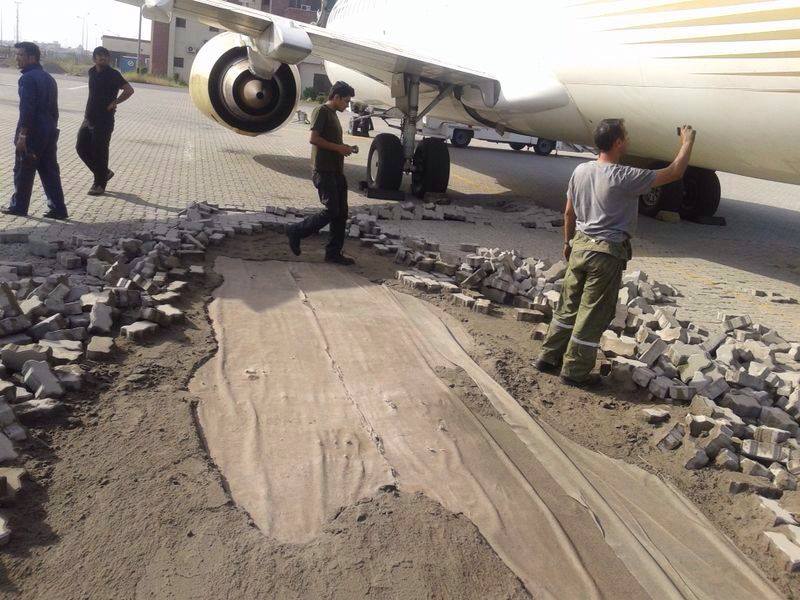

  • A routine high-power engine test of a Shaheen Air International Boeing 737-400 at Pakistan's Sialkot International Airport severely damaged both the aircraft and the ramp.
  • The ramp, constructed from interlocking concrete paving stones typically used for patios, proved inadequate for the 20,000 pounds of turbofan thrust, disintegrating into flying debris.
  • The concrete "missiles" caused extensive damage, including numerous dents and skin piercings to the aircraft's fuselage and tail surfaces, raising questions about its repairability.
  • The incident points to a significant engineering oversight regarding the ramp's construction, which was clearly not designed to withstand jet blast.
The engineer who signed off on the construction of the ramp at Pakistan’s Sialkot International Airport likely has some explaining to do after a Shaheen Air International Boeing 737-400 rearranged it some during a routine engine test. Engineers did a high power run-up of the No. 1 engine on June 19 and turned the parking area into a maelstrom of FOD. It appears the hard surface was made from the interlocking concrete paving stones that are commonly used for patios and garden walkways. They are set in a sand bed and interlock with each other, which is more than adequate for foot traffic and the occasional bicycle but not really up to 20,000 pounds of high bypass turbofan thrust from a CFM56 engine.
The jet blast threw the concrete missiles, each weighing a few pounds and with lots of pointy facets, into the fuselage and tail surfaces. A few dozen ended up on the horizontal stabilizer. Photos on an air maintenance engineers’ Facebook page show numerous dents and skin piercings and hundreds of bricks spread behind the aircraft. Although the airline undoubtedly sees little humor in the incident, there are plenty of insightful comments on the Facebook page. It’s not clear how much it will cost to fix the damage or whether the aircraft can even be repaired.
