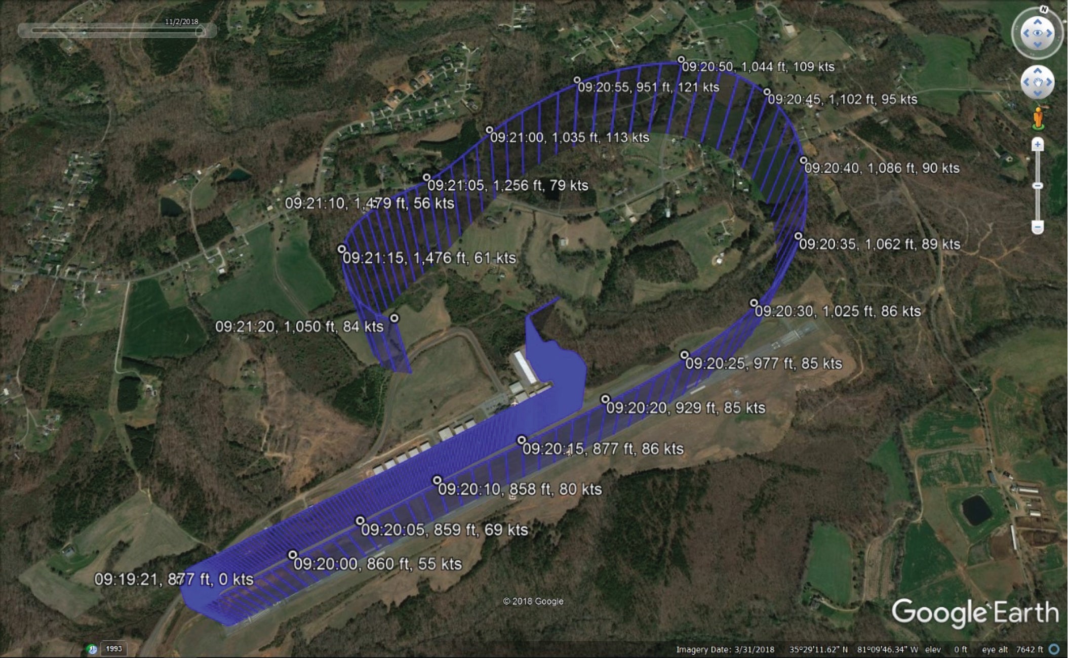

Data from an Appareo Stratus 2S portable ADS-B In receiver indicated the airplane departed Runway 05 at about 0520. At about 0520:25, the pilot initiated a left turn as it climbed from the runway. The airplane continued the climbing left turn to about 1100 feet GPS altitude and attained a groundspeed of about 95 knots. Then it descended to about 950 feet and accelerated to a groundspeed of about 121 knots on an approximate left downwind leg for the departure runway.
By about 0521:10, the airplane had climbed to 1480 feet GPS altitude and decelerated to about 56 knots groundspeed. The airplane subsequently entered a descending left turn; the final recorded data point captured a GPS altitude of 1050 feet and a rate of descent greater than 4000 fpm. The accident site was in an open field about ½ mile northwest of the airport.

At right, the accident airplane’s flight track, as determined by a portable GPS device, is overlaid on a Google Earth representation of the departure airport, showing how close the pilot got to his goal of attending EAA’s 2018 AirVenture fly-in.
