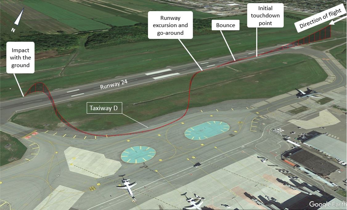

  • The crash sequence involved a nosewheel-first landing, a bounce, veering off the runway, and a subsequent stall/spin at low altitude during an attempted go-around and turn.

Canada’s Transportation Safety Board says a pilot’s first solo ended in disaster at Quebec City’s Jean Lesage International Airport, but it didn’t specify a cause for the crash. The student was seriously injured but survived. The board highlighted all the precautions that flight schools and instructors should observe before sending a new pilot aloft for the first time and reminded pilots, regardless of experience, “of the importance of being vigilant upon landing to quickly detect any signs that a go-around is required, and to be able to initiate the go-around at the appropriate time.”
This video also shows just how quickly a stall/spin can develop. The report noted this airplane was only 45 feet above the ground and crashed vertically into the infield. The student was enrolled in a first officer’s program at Orizon Aviation and had done eight touch-and-goes before the instructor got out. The student landed nosewheel first and bounced before veering off the runway. It was at that point the student tried the go-around and barely got off the ground. An attempt to make a turn with the plane in very slow flight stalled the left wing.
