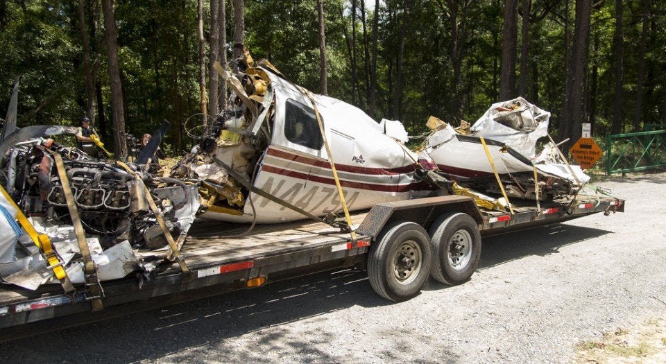

The Piper Navajo that crashed in Tuscaloosa, Alabama, this month, killing all six people aboard, had two fuel pump failures in flight. The twin had departed Orlando, Florida, Aug. 14 bound for Oxford, Mississippi. At 11:11 a.m., the private pilot reported a fuel pump failure to ATC and requested a diversion to the nearest airport, according to the NTSB’s preliminary report this week. A controller vectored the Piper to Tuscaloosa Regional Airport. About 10 miles from the field, the pilot reported failure of “the other fuel pump” and the aircraft descended until crashing into trees about 1650 feet from Runway 30 at KTCL, the report said. Investigators found a flight log found in the aircraft showing the pilot had flown the Navajo since March 2016 and logged about 48 hours in it.
