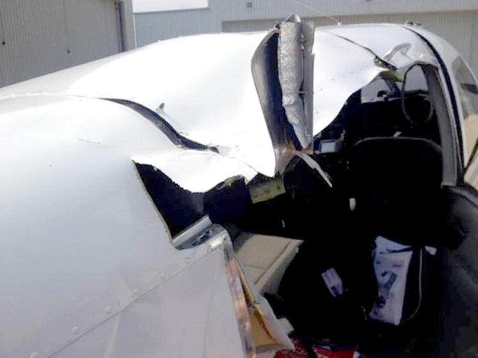

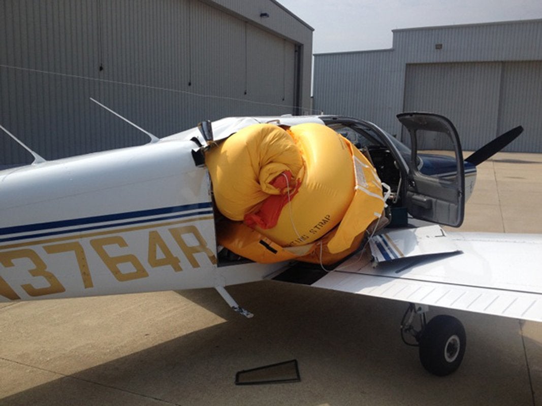

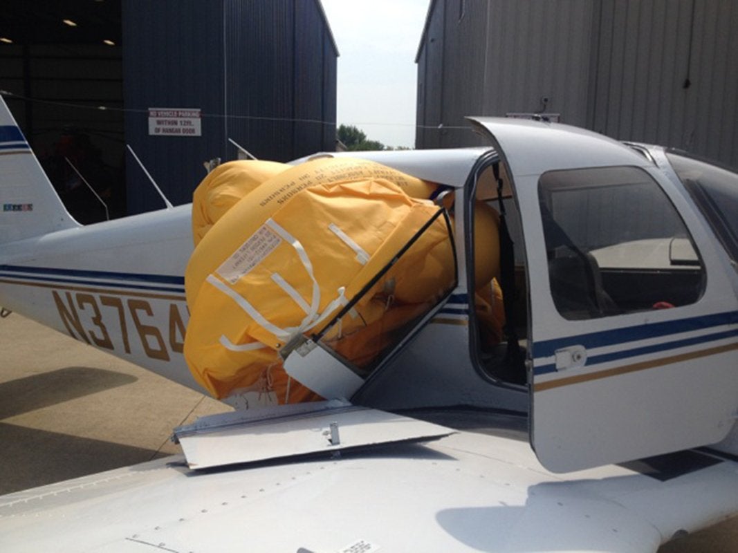

“Just as we were about ready to close the door, we had it all loaded, it went off. It inflated and it had no place to go so it was out the side of my airplane,” Pflum told me. And that’s no little four-man raft, either. Pflum said he wasn’t certain of the size, but it’s the sort of raft tossed out by the Coasties when a ship or ferry is in extremis. He thought bigger than a 20-man, but less than a 50-man. The inflation cylinder is a little smaller than a scuba tank. That’s a lot of volume.
And obviously, all that CO2 did a lot of damage in its quest for equilibrium. It took the Cherokee’s baggage door right off its hinges and peeled back a section of the cabin roof like a sardine can. It did not, however, impinge into the cockpit area leading Pflum and I to wonder if the airplane would have been flyable if this had occurred in flight. My guess is it would have been, although it would have been no fun trying to land it. The larger danger is a raft on the backseat or co-pilot seat impinging on the controls during an unintended inflation, forcing an uncommanded and maybe unrecoverable pitch down. Thus the advisability of having a knife handy. In a pinch, a suitably adrenalized pilot could probably use a pen to deflate a raft, but a knife is preferable.
Spontaneous inflations of rafts aren’t everyday events, but they’re far from unknown, either. Pflum told me the Coast Guard has had these rafts self-inflate before and their new policy is that they can’t be shipped without the inflation mechanism being removed. Many inflations are due to an accidental snag of the lanyard, but that wasn’t the case here. The lanyard was stowed and the inflator appeared intact, not intentionally pierced.
