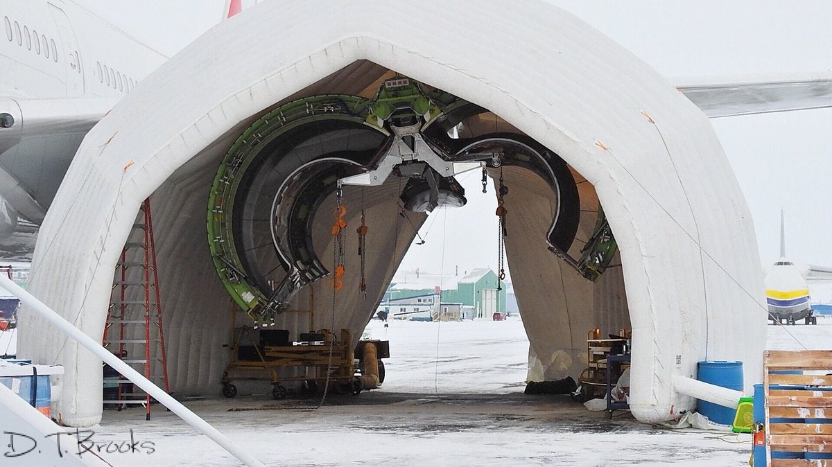

  • An engine replacement was required and performed outdoors in challenging -30 degree Celsius weather, using an insulated tent and heaters, as the aircraft was too large for local hangars.

A couple of days later, a chartered An-124 delivered a replacement engine but the 777 was too big for any of the hangars at Iqaluit, which is served by two airlines whose largest equipment is 737s. An insulated tent was pitched around the engine and heaters fired up inside against the -30 weather. With help from the airlines and a local maintenance shop, the Swiss mechanics swapped the engine and the aircraft was able to fly back to Zurich Feb. 8.
