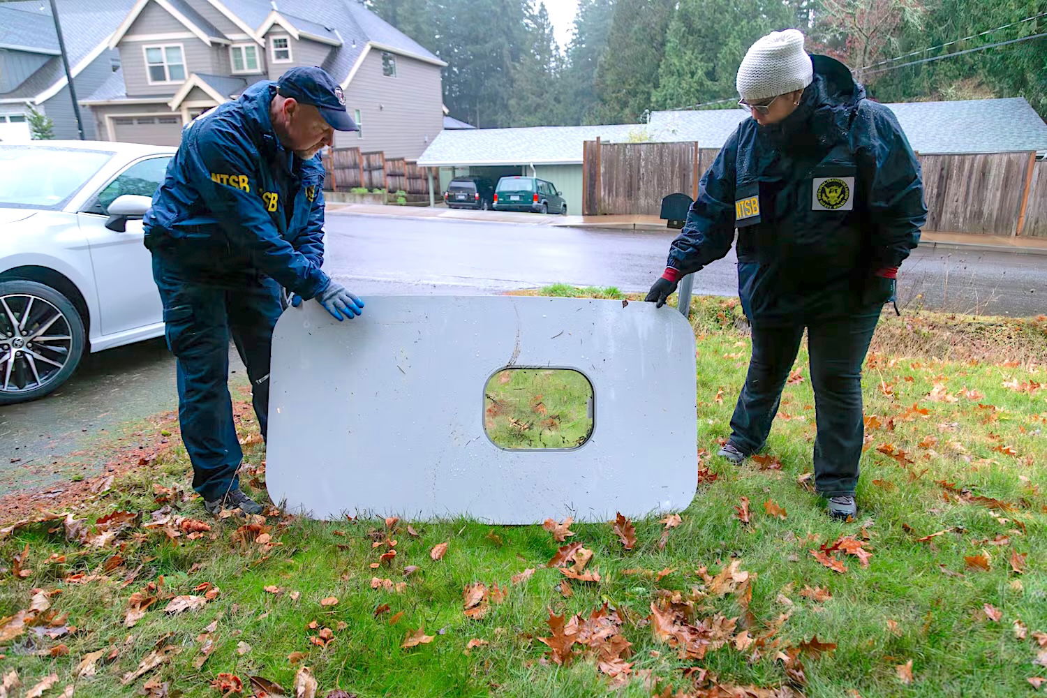

Mid-Exit Door (MED) plug from Alaska Airlines Flight 1282. Credit: NTSB

  5. Concerning that people would do something involving undoing bolt and not record it.
    Different from just unlatching a standard 737 overwing exit.
    In this case the exit had been de-activated hence the bolts, no handle inside, I presume had to remove at least a bit of trim to get at the bolts.

  7. Concerning that people would do something involving undoing bolt and not record it.
    My understanding is that the removal was recorded, but, due to software incompatibility, the replacement procedure was not triggered.
    Nothing to deactivate; the exit hardware was never there - nothing to activate in the first place. Just a plug secured by spring-loaded fittings, with four bolts that locked the fittings closed.
    Yes; the interior paneling was removed.
