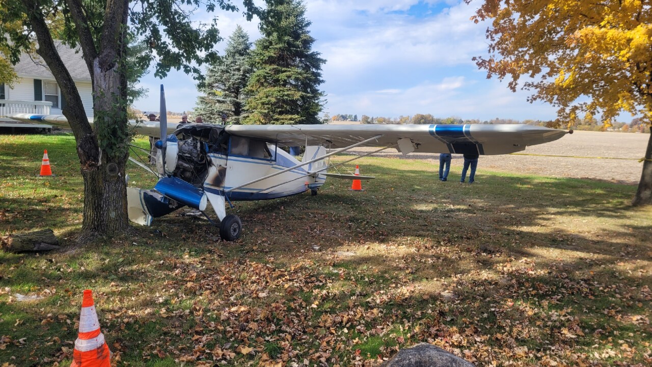

The preliminary report noted significant front-end damage to the aircraft, including tree bark embedded in the No. 3 engine cylinder during the crash. The propeller remained straight and showed no curling or polishing, which appears to be consistent with minimal power at impact. The firewall and cabin sustained thermal damage.
Investigators found the mixture control full-rich and the throttle partially out. The ignition switch was set to “both.” Although the fuel selector had broken free in the crash sequence, fuel was dripping from its attached line, and about seven gallons remained in the single fuel tank.
Control continuity was confirmed for the elevator, ailerons and rudder and both wheel brakes functioned when tested. The wings remained attached, though internal ribs and spars were cracked and the fabric covering was wrinkled.
Engine examination showed impact damage to the No. 1 and No. 3 cylinders and cracks in the case near those locations. A borescope inspection revealed no internal anomalies, and investigators were able to obtain thumb compressions on all cylinders. Both magnetos produced spark, and all eight spark plugs appeared normal based on manufacturer guidance. Fuel system components, including the gascolator and carburetor, were clean and contained fuel free of water contamination, the NTSB said.
