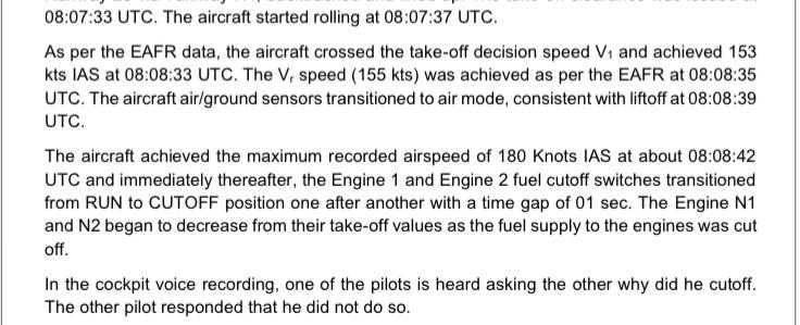

The preliminary report into the crash of Air India Flight 171 in Ahmedabad last month says the plane came down after fuel was cut to both engines seconds after takeoff. As we reported earlier, leaked reports said the investigation was focused on the fuel cutoff switches. India’s Air Accidents Investigations Branch said in the report that the switch controlling fuel flow to the left engine was moved to the “cutoff” position four seconds after the wheels left the runway, and the switch for the right engine followed one second later. Almost immediately, one pilot asked the other why he had moved the switches, but the second pilot said he did not move them. The switches are immediately below the thrust levers and are designed so they must be lifted before they will move to the cutoff position.
About eight seconds later, someone restored both switches to their correct position but by then the plane was descending and while the engines appear to have automatically relit, they did not produce significant thrust. The ram air turbine deployed about five seconds after the fuel was cut off. A pilot issued a Mayday, mentioning a lack of thrust, and the recording ended six seconds later. The plane crashed into the campus of a medical school a few seconds later, killing 19 people on the ground. All except one of the 242 people onboard was killed. A British passenger walked away from the wreckage with serious injuries. The lack of any kind of repair or defect advisory from Boeing or engine maker GE suggested mechanical faults were not part of the investigation.

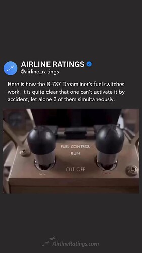

  2. My thoughts, as well, Jason. I saw pics of the switches; they’re of the type that have to be pulled up and past definite lockout tabs to be put in the opposite position. I have some of those in my hangar stash and looked at 'em just today. I wonder if this isn’t another suicide situation? Bumping those wouldn’t work to move them. And even if were the cause, how the heck would two of 'em be moved? The airplane couldn’t have taxied all the way to the runway with those switches ‘off,’ so human intervention HAD to occur. There’s more to this story …
    Beyond that, I’d question why they were placed so close to the power levers? There ought to be a panel with all emergency control function switches in one place where a glance could confirm positions and allow rapid access to them. Were I designing the airplane’s functions, that’s what I’d do AND I’d have a warning light if ANY switch was in the wrong position for normal ops.

    The 787 fuel switches turn the fuel off - period. There is no system to disable them if the airplane doesn’t think you should be doing that. Boeing assumed the pilots would not turn the fuel off at random times just to see what happened next.

    I have never flown a plane in my life where this was not possible and I bet you haven’t either.

  14. Data matters, Larry. If both switches moved within 1 second, I’d fly with human interaction. Initially the breathless media reported (referring to compiled data in the initial assessment) that the switches moved within 0.1 seconds.

    I bet both switches could pulled and be moved simultaneously with one hand, but regardless I don’t think moving both switches within 1 second of each other is anything exceptional.

  18. Initial press releases stated that the switches had been moved to off within 0.1 seconds.

  27. “Why did you do that?”. That question on the recorders implies that one of the pilots saw the other pilot shut off the fuel! The question would not have been asked if the issue had not been actually seen. So, it is known who asked and who replied. It is also know what was the tone, urgency with that request. Answer. One of the two deliberately shut off the fuel. Why? We might never know.

  34. Turning both fuel cutoff switches within 1 sec is quite possible in normal operation. Turning both off simultaneously with one hand is possible with sufficient hand size, but would be difficult.
    The AFDR can only record the electrical state of the switch, not the physical position. Since these are electrical switches that send a signal down a wire to an electromechanical device (with or without a software intervention) it is possible for a wire fault (e.g. short) to cause the fuel cutoff valve to close regardless of the switch position. It is not clear where the AFDR gets the fuel cutoff switch state from. It could just be the shutoff valve position.
    Having the fuel cutoff switches/levers below the throttles has been a feature of jet transport aircraft design from the very beginning. If this is a design fault leading to inadvertent shutting off of engine fuel supply, it should have cropped up before this accident.
